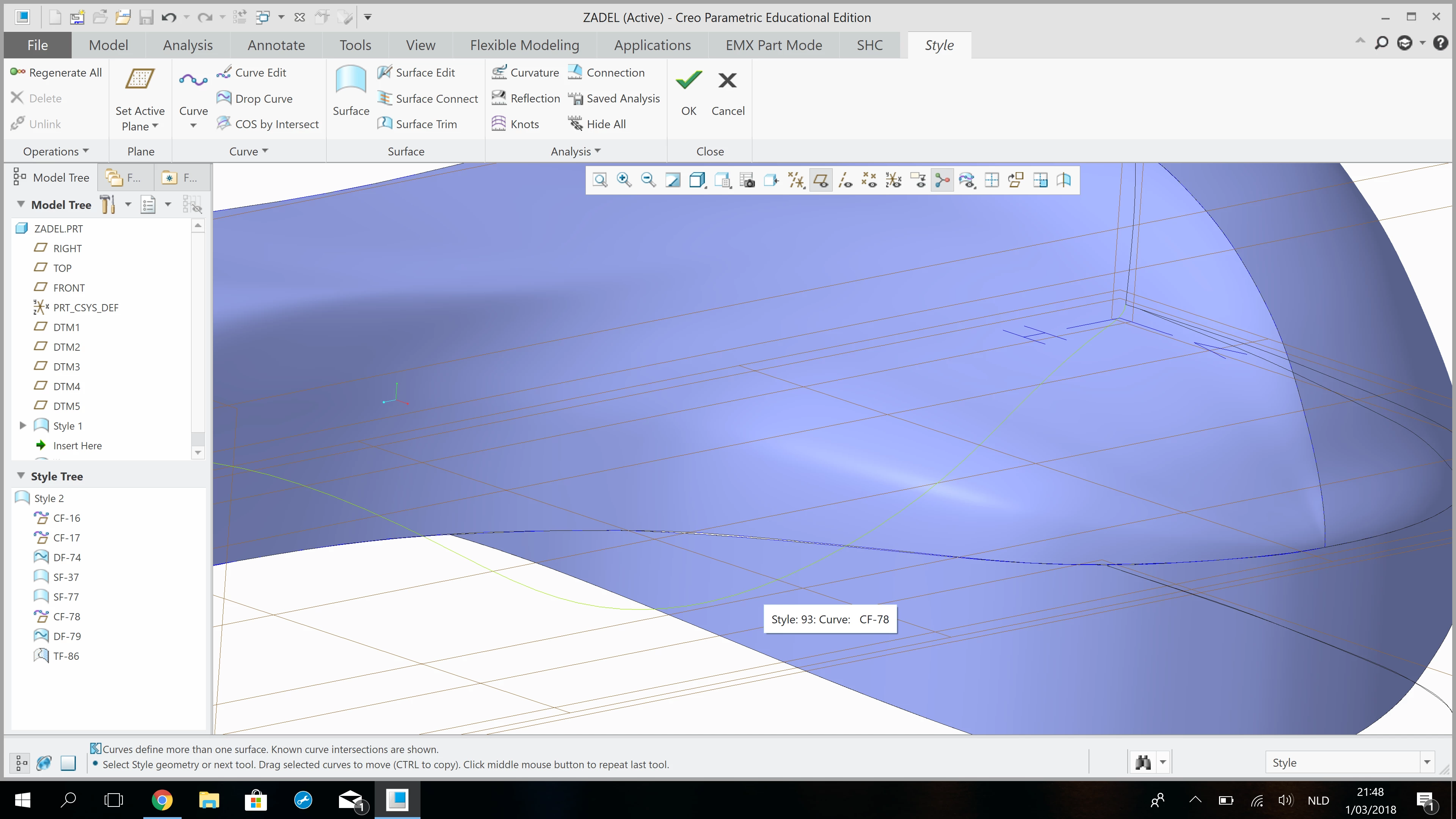

Hello everyone! I have a problem with two surfaces that won't connect to each other.
When i click on Surface Connect and click my Two surfaces.. Nothing happends when clicking ok.
Is there a possibility to solve this problem? Thanks in advanced!

Best answer by TomD.inPDX
Let me suggest another means to attack your challenge...
One thing that works well with stylized design is to "extend" surfaces.
Bring the edges of your surfaces out further and trim them to shape.
The red dot is what I am going to refer to as a "knot".
This often happens when you force a surface definition into a corner.
Remove the corner by "extending" the surface definition.

Merge - ... is in the model tab.  Highlight both surfaces and the merge feature icon should highlight.
March 1, 2018
Won't work.. Tried several times..
March 1, 2018
Then there is probably a mismatch between surfaces.  I see a knot in the triplet corner.
