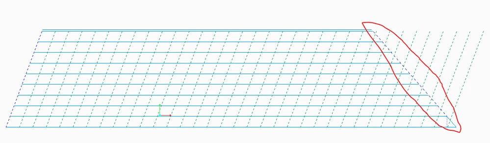

Dear Expertes,
As you can see the below image. Is there any way i can control the pattern so that the geometry should not cross the trapezoid boundry.
With Regards
Aghil.M

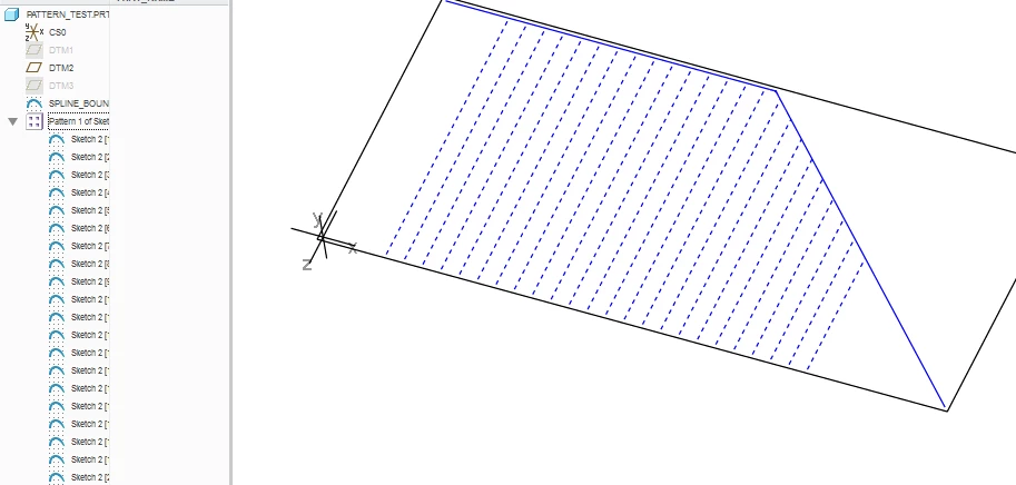

Best answer by psobejko
Try using the "convert to spline" function in the sketcher->operations->convert to->spline.
Sketch the boundary shape using lines.  Select them, and convert to spline.  This results in a single entity, that you can then use to constrain the endpoint of your vertical line in the sketch that will be patterned:
August 7, 2017
Hi @psobejko
Thanks a lot for the reply. This is what i was exactly looking for,
