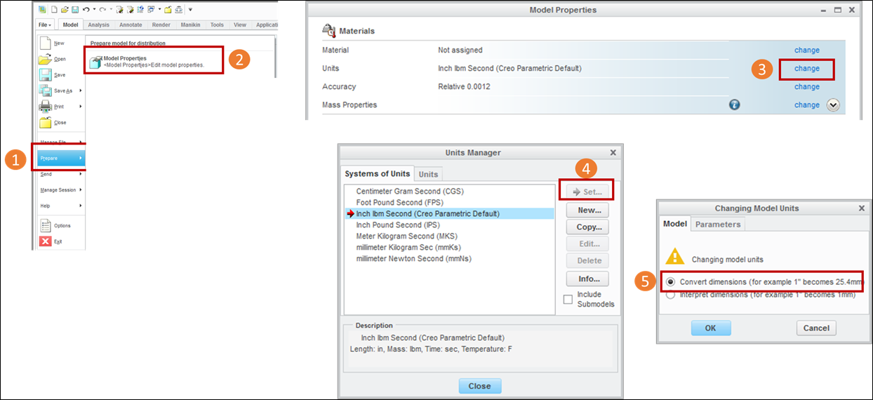

have a fabricated housing made up of approx. 10 parts.  it's modeled in inches.  how can i change the entire assembly at one time?  tried model properties including sub assy's but no dice.
tried to change properties one at a time but encountered errors.  anyone help?

Please follow below step for assembly to convert unit change.

What error message did you encounter when you tried to scale using sub-models? (I'm assuming you meant sub-models instead of sub-assy's)

Stephen, I did not get an error message.  what I was hoping was when I selected the metric values and the sub models I was hoping it would convert all the parts to metric.
my assembly consists of various steel plate objects.  after the program ran and I would open one the parts and go to "edit" the dimensions were still in inches rather than mm's.  if I remembers correctly,  if I measured from surface to surface I would see the metric value.   not  sure when I went to the "edit" it showed inches.

I just tried it using a test assy. I created 2 parts and 1 assy, all in inches. Then I changed the units and used the include sub models check when I changed it.
It worked.
Can you attach the models?
You could also try a test model to see if it's something specific with those files.
