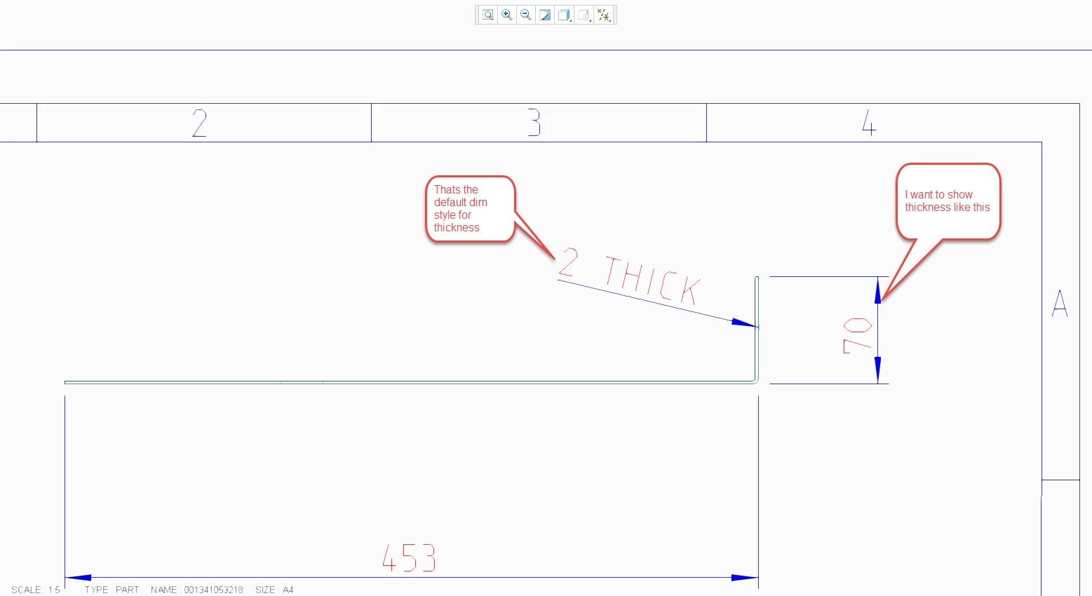

Helo all,
I have started creating sheet metal parts in CREO 3.0, and he problem I am facing is that whenever I give annotations to the part using "Show Annotations" tool it gives me thickness of the sheet metal part as single arrow pointing towards the thickness and dimension written over it. I want to show this thickness as linear dimension just as you show normal thickness of a part. I just cant find a way to do it help me out please!
Note: I am only allowed to display dimension using "Show annotations" tool, I cant give dimension manually, by selecting the dimension tool.
Image is attached for clarification.

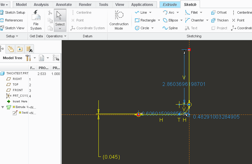

The only way I can think of is to add a reference dimension to your sketch.
In this case, I used the thicken command under setup - feature tools and then added the dimension. It's reference, but in the drawing, you can remove the parenthesis.
There are certain "rules" that companies (or people) make about using only shown dimensions that do not work in the real world, especially in sheet metal.

Please clarify; you are making drawings of sheetmetal parts, and your company policy does not allow you to add dimensions to a drawing?
What about "annotations" added to the model before drawing is started?  One of these could be a (manually added) thickness dimension...
Depending on how you are making your sheetmetal parts, and what the documentation requirements are, it may not be easy to create drawings using "shown dimensions" only.  For example, feature dimensions do not get mapped to the flat pattern locations (when you show them on the drawing of the flat pattern, they point to the "formed" location).

Yes I am making drawings of sheet metal parts and the company policy does not allow e to add dimensions in drawing. I hav to add them in the model and call up from 3D model to the drawings.
For now i am manually adding dimensions of thickness to the 3D model but it should not b done this way, I have to use "show annotations" feature to use dimensions frmom model. But I guess there isnt really anyway of showing thickness dimension the way I want to.
