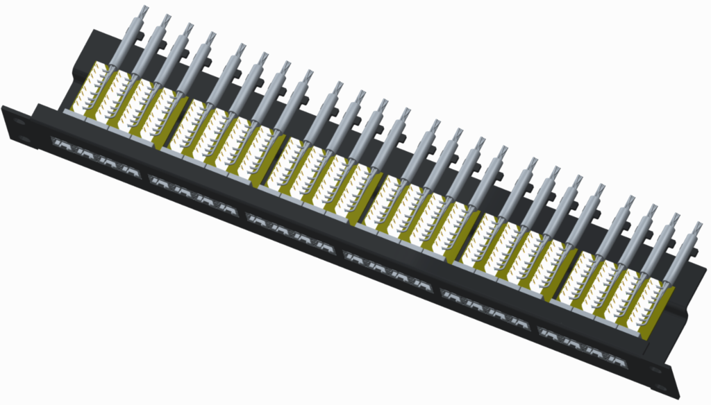

March 19, 2015
There is another way (in Creo2.0, not sure if it works in older versions).
It will lose the cabling information for the repeats, but it saves creating shrinkwraps. So has the benefit that modifying the parent cable harness will immediately update the children.
Exit cabling application
Select the harness part from the assembly model tree.
Right click, "Move to New Subassembly"
Call this file, e.g. "HARN_PART_WRAPPER.ASM"
Then in your model tree you can use repeat or pattern as you would any other sub-assembly.
Here's one I made earlier
