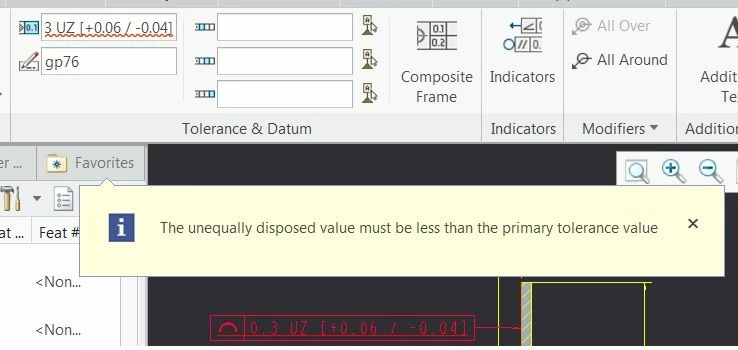

Hello everybody,
I want to create a line shape with unbalanced tolerance zone.  There is always an error.
How to do that correctly in Creo4 with MBD? Thanks!
Br
Sun
Best answer by Mahesh_Sharma
@sundoopi
I think the error in image is because of format for value mentioned after UZ.
If you will define this as 0.3 UZ [0.03], it will not report any error. But if it will be +#.## / -#.##, there will be error. Can you share any image or details about standard which defines this value after UZ.

@sundoopi
sundoopi1-VisitorAuthor
December 27, 2018
Hello MaheshSh, you are right. If +#.## / -#.## is changed, only +#.## or -#.## is used, there is no any error. Thank you.

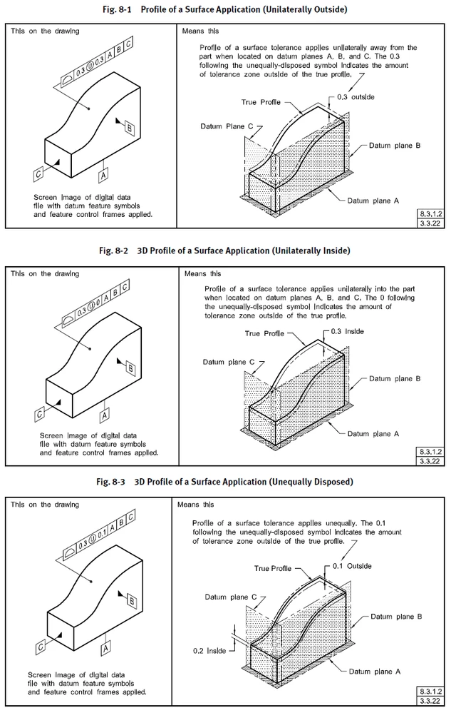

Not sure which standard you're using but ASME Y14.5-2009 shows this entered differently.
Mahesh_Sharma
22-Sapphire I
October 18, 2018
Hi @TomU
@sundoopi is using ISO standard for unequally disposed tolerance zone....
http://support.ptc.com/help/creo/creo_pma/usascii/index.html#page/model-based_definition%2FISO2012%2FOptional_Modifiers.html%23
October 18, 2018
Sounds like the basic usage is still the same.  The single value after the UZ (or U) just shifts the tolerance zone around.  I think he is confusing where the zone is located with the size of the zone.
