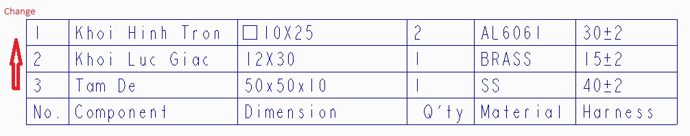

This is BOM automatic but i want custom.
I want change No. 1 2 3 ( now 3 2 1 )
How to change up or down ?

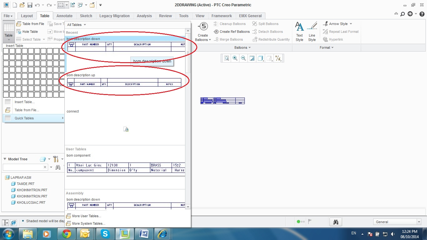

Best answer by MartinHanak
  • create new table with 2 rows
  • set table growth direction > rightward and descending
  • define repeat region in 1st row
  • put header titles into 2nd row
Martin Hanak
October 8, 2014

I'm understand. Thank you so much !
