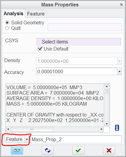

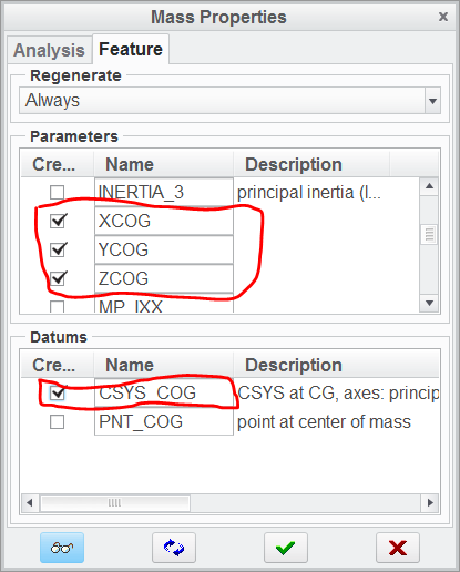

Jitu,
you can create Mass Properties analysis feature in your assembly and create some parameters and datum features (see pictures).
The creation of datum features is tied to license module named Behavioral_Modeler. If your license does not contain this module, then you can use parameters and relations to build the center of gravity manually.
Martin Hanak
