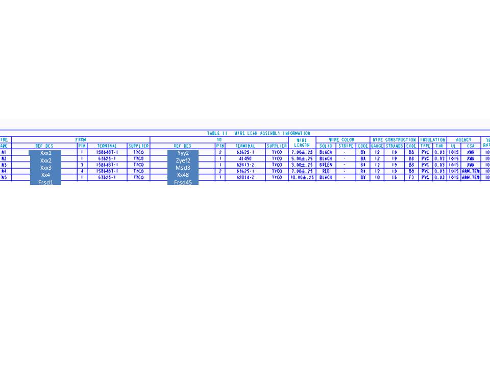

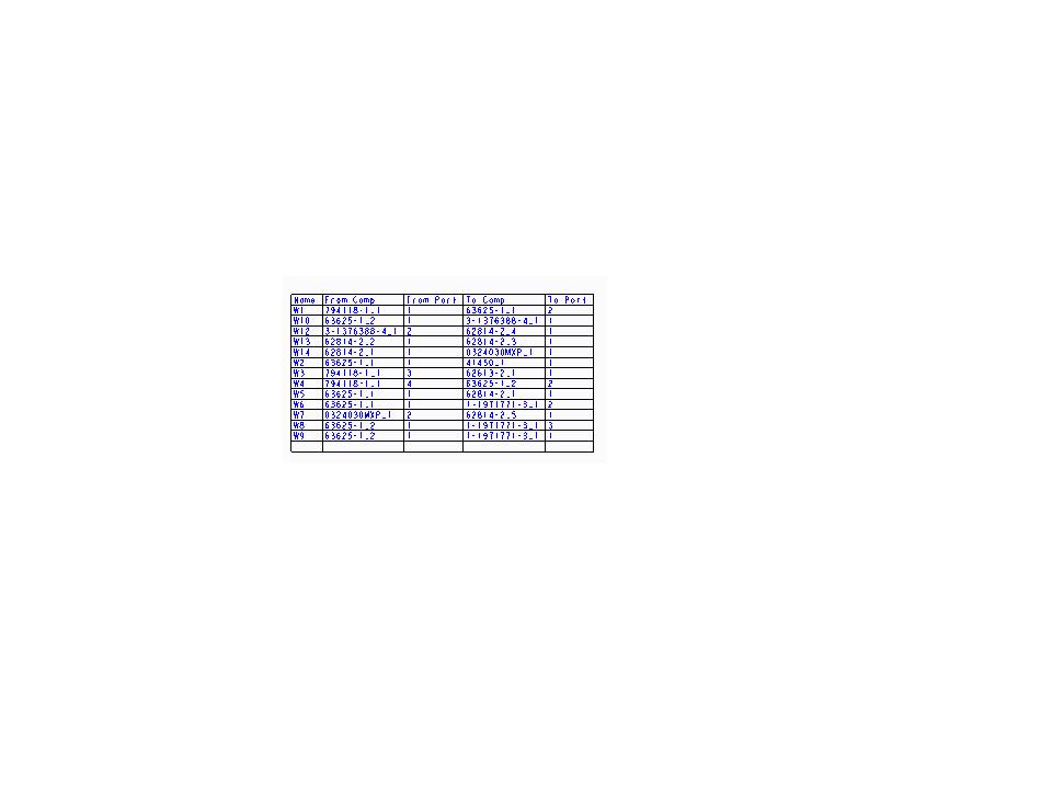

I want to make From To tables like below.
I've created from to tables from .rep & .fmt like below. this fromats got from one of my friend. I donot how to create new formats. please help me out.
