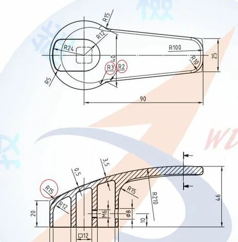

I have created a 3D part in Creo Elements/Direct by following the dimensions of the 2D drawing
2D dimensions are showned bellow:
The red circles in 2D drawing are the variable blends which I want to create in 3D part.

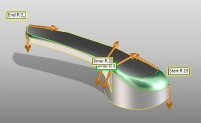

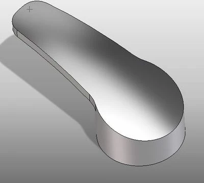

Picture below is the 3D part. Top edge of the part is where I want to create variable blends.
Because software doesn't allow user to create variable N blends on closed edges.

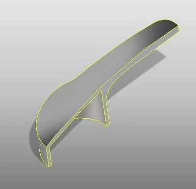

So I cut the part in half and then use variable N blends.

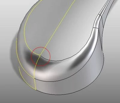

Finally, I mirror the part. But the problem is that there are discontinuities on the mirror plane.
Is there any method which can create the smooth variable blends on closed edge.
