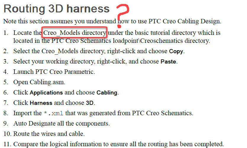

Hi Jim
I followed the get started tutorial in schematics, but at the most interesting point (routing the cables in 3D) they asked to find a directory that doesn't exist on my computer (see attached file). Maybe i don't look on the right place?
Anyway do you know who to get this directory? (Which should have been given with the license..)
It would be of great help!
Thank you,
February 5, 2017
Hi Ambroise
Please search the installation folder of Creo schematics for cabling.asm.
The location of the creo models directory on my machine is D:\PTC\Creo 4.0\F000\Schematics\creoschematics\basic_tutorial\pro_engineer_wildfire_models
I hope that helps
