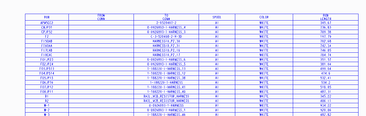

November 24, 2014
Hi Guys,
I have the same problem when I am trying to add parameters to be shown in the table of BOM for a harness drawing. I have added a table which shows the wire name, the from conn, to conn, spool etc. The problem is related to the from/to conn columns. Initially I have put : harn.run.cond.from/to.conn.name. The fact is that I want to replace parameter: name, with a user defined parameter (I use the parameter PARTNR) to show the part number of each connector, instead of the name.
When I use the parameter PARTNR (harn.run.cond.from/to.conn.PARTNR), the columns become empty. I attach some pictures to show what is going on.
Thamks in advance.
