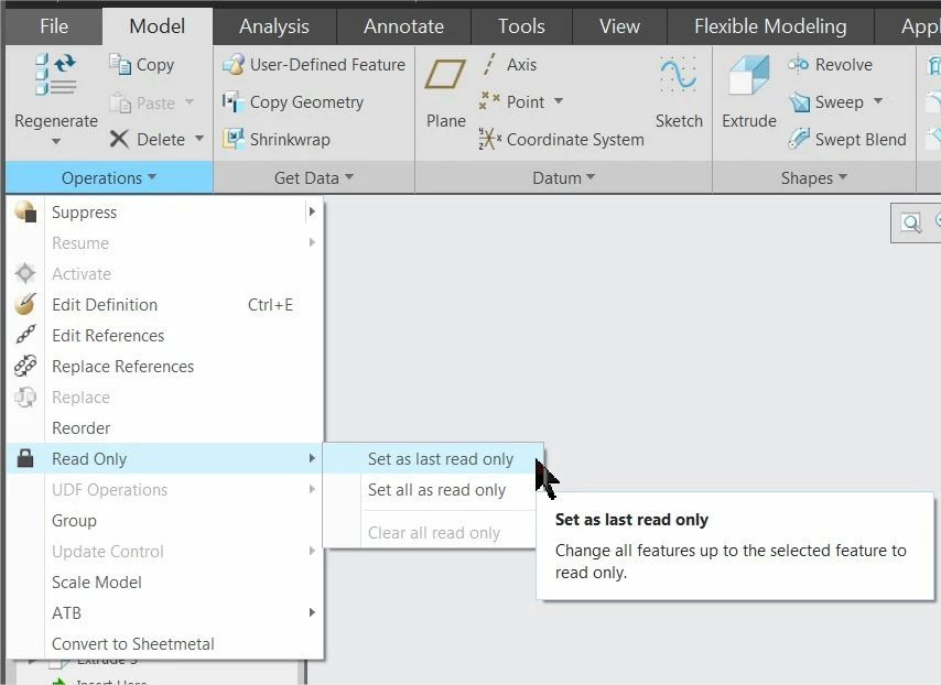

January 3, 2019
Hi Hshagle,
You could try 'set read-only features', I am not sure if this improves regeneration time...
