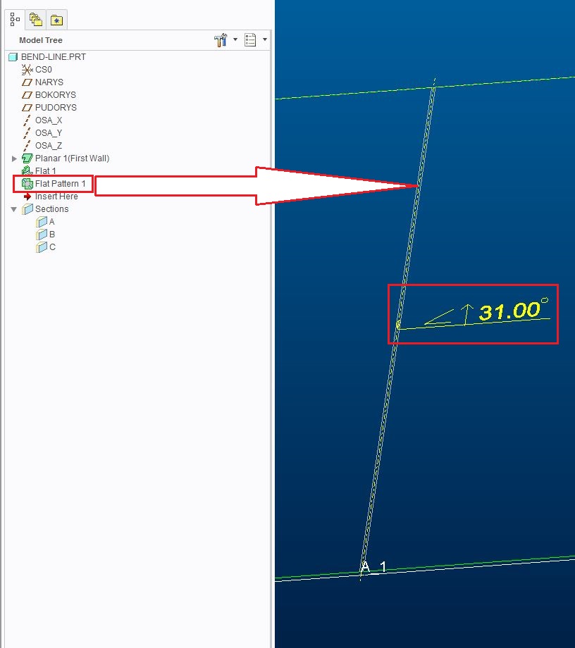

I made planar feature in sheetmetal part.
And added flange wall on edge.
After applied flat pattern I would like to display bend line.
If impossible I would like to display original egde in flatten state.
Is it possible?
Best answer by mbonka
Hello Yong Bok Seo
if your flat pattern was created succesfully, then should be created "bend axis" (in my opinion the same like bend lines). See attached picture.
In praxis l´m using this bend axis to sketch lines for engraving ---> it makes work easier for guys from workshop.
Hope it helps...
Regards
Milan Bonka

Hello Yong Bok Seo
Hope it helps...
Regards
Milan Bonka

Hello Milan Bonka
I am really happy to get your good solution.
Thanks a lot
