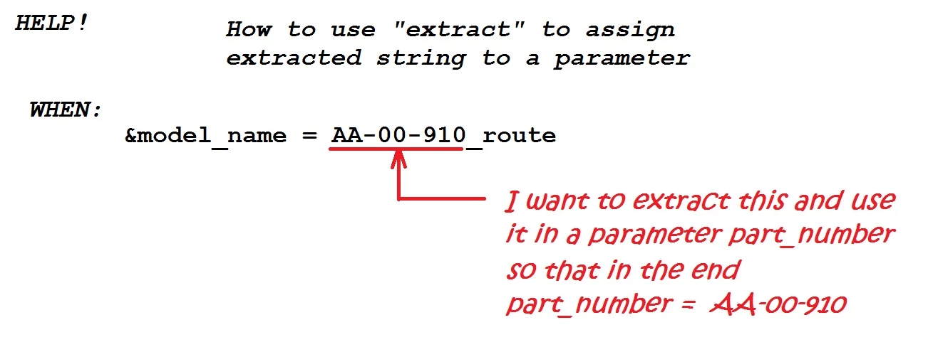

I need help extracting a string from a system parameter to assign it to a user defined parameter.
Any help would be greatly appreciated.  Please see attached where I explain better what I'm trying
to accomplish.
Update: been trying and it doesn't like system parameters such as model_name.  I can use any other user defined
parameter and it works fine.

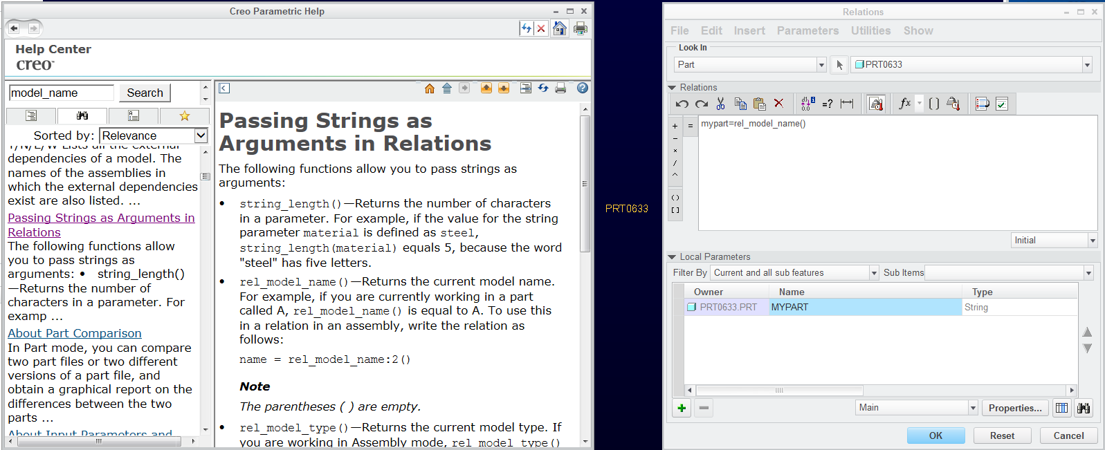

If I understand what you are asking, you are also having trouble making the model_name parameter into relations.
This is the trick to make the current model name a relation.  This can be manipulated to extract the substring.
The text string in the graphics window is &mypart in annotation.

Excellent!  Thanks for your help TomD.inPDX, Got me going in the right direction.
Here's the relation that worked for now:
part_number=(rel_model_name)
part_number=extract(part_number,1,9)
RESULTS IN:
part_number = AA-00-910 (this is good)
But what happens when the part number has more than nine characters?
For example, now I have an assembly where the model_name = AA-00-1234_route.asm
If I use the above expression:
would yield:
part_number = AA-00-123 (truncating the part number, it will leave out the number "4" resulting in an incorrect part_number.
