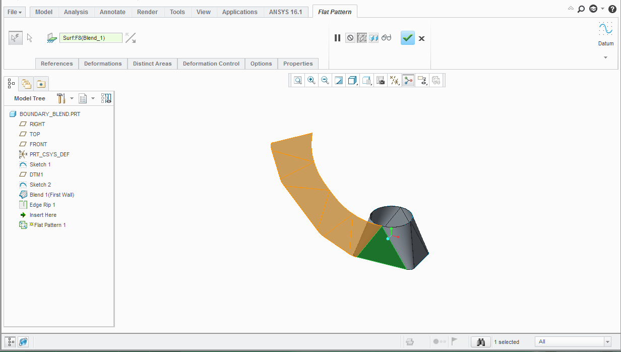

In sheet metal i'm having one part. It Unable to get a flat pattern in CREO 3.0.
8 replies
8-Gravel
April 11, 2017
Its an alternate method but gives you the same result what you want.
Please find below image for your solution.
Please try with the features in the model tree what i used.
Jimmy
rkumar-71-VisitorAuthor
April 12, 2017
Thank you for your support jignesh vadalia..
