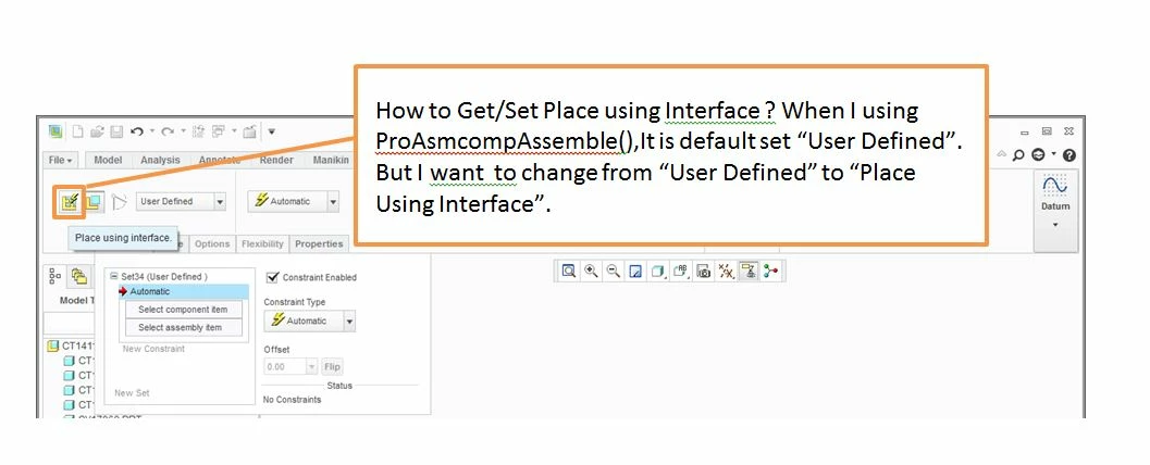

How to Get/Set Interface Place Type(IntfcPlaceType) when I populate new part into current assembly using ProAsmcompAssemble()
  • July 28, 2015
  • 1533 views
I want to assemble new part into current assembly using ProAsmcompAssemble().
But I am not able to get or set "Place using Interface" Type by Default it set "place manually".
Best answer by gkoch
I believe it should work, if you create the assembly component using an element tree.
The element tree defined in the header file ProAsmcomp.h contains tree elements PRO_E_COMP_PLACE_INTERFACE, etc...
gkoch2-ExplorerAnswer
2-Explorer
July 31, 2015
