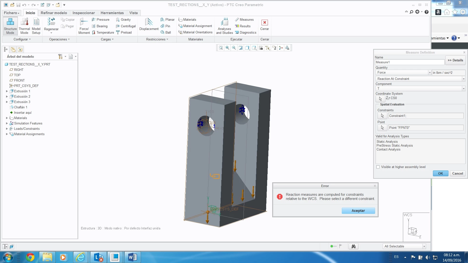

Hello there,
This maybe a simple thing but I just can not figure out how to do it.
Here is the thing, I have a simple part that is constrained at the hole, of course the load is applied.
Now at the measures tab I can "measure" the resultant forcé at the constrain however if I try to "measure" any of the components  x,y,z it gives me an error, it tells me reactions measures are computed for constrains relative to the WCS...please select a different constrain...
ok first question, why is it?
how can I measure the omponents of the resultan force at the constrain?
See file attached
I really apreciatte any help on this
Antonio

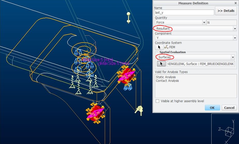

Best answer by pkloninger(cust
alternative
Regards
Paul
September 14, 2016
alright, I think got it fix... basically  I had a new WCS based in a cylinder, that was the mistake, it has to be cartesian, now it Works
anyway other advises are welcome
September 14, 2016
alternative
Regards
Paul
