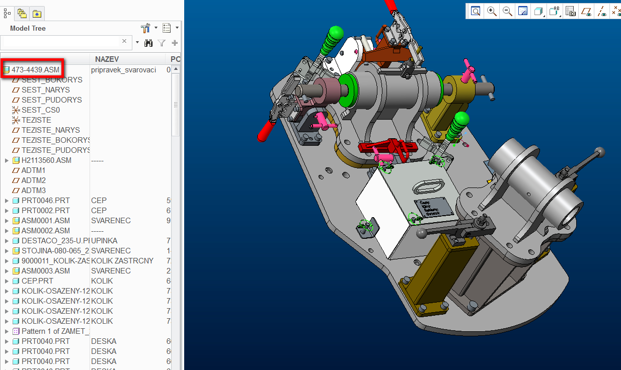

assembly name is a model name of top level assembly (pic1)

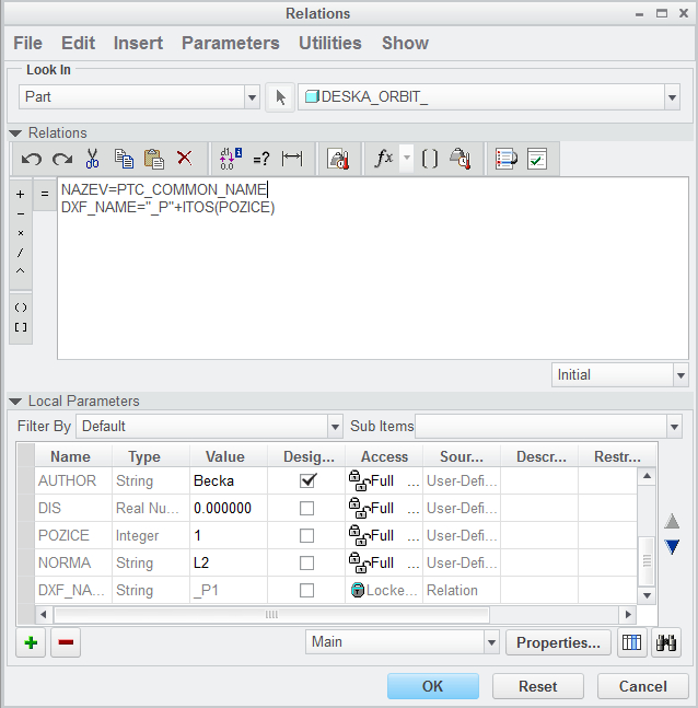

the parameter value is actually a bouble number made by integer and some extra symbols added (pic2, paremeter DXF_NAME)
the name of exported dxf should be 473-4439_P1 in this case
