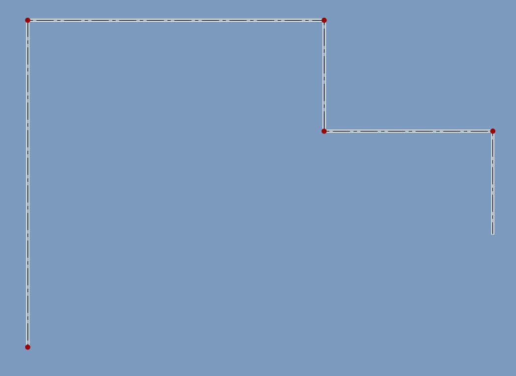

Hi..
I want to hide the points and center line of pipe in drawing as shown in below snap.
so pls anybody suggest, how we can do this ?
I have shared data for reference.
Prashant pandarkar
Best answer by Mahesh_Sharma
Prashant,
You may try setting config option pipe_solid_centerline as no and drawing option hlr_for_pipe_solid_cl as yes

If you put the feature on a layer and blank the layer, the non-solid portion of the feature will be blanked as well.

Prashant,
Did you get this working? Don't forget to mark appropriate reply as correct answer.
July 8, 2016
Yes it works. Thanks
