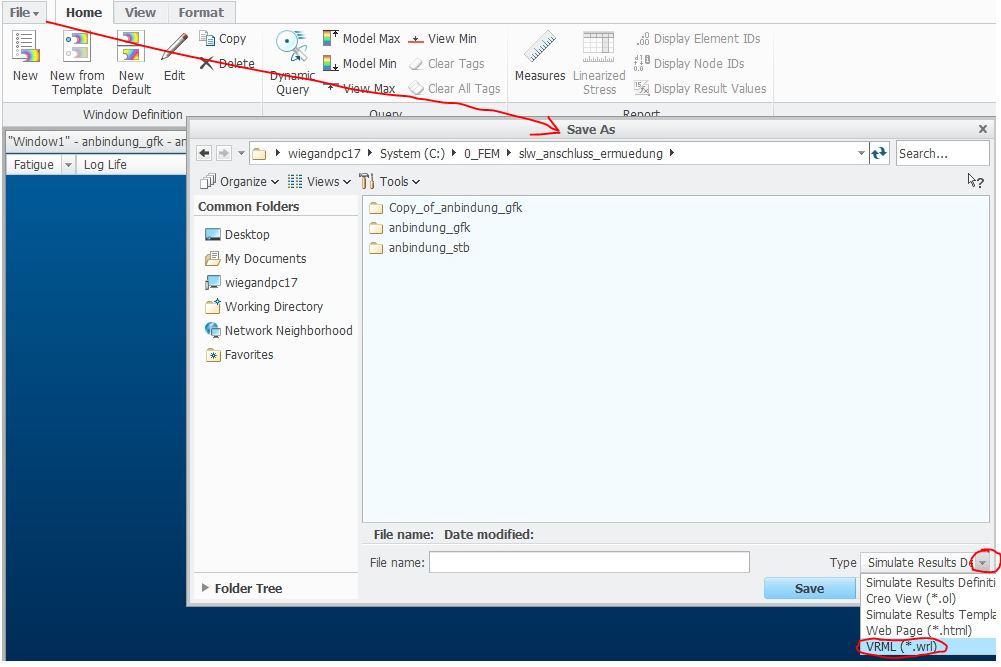

For example, I make static analysis for spring deformation. so I want to export the deformed spring to original 3D model (not in simulation mode) for detail check, is it possible to do it?
Thanks.
Best answer by skunks
yes, step 1: export VRML
step 2: import
regards
paul
skunks
skunks19-TanzaniteAnswer
May 10, 2017
step 2: import
regards
paul
skunks
May 10, 2017
creo 3 and later:
