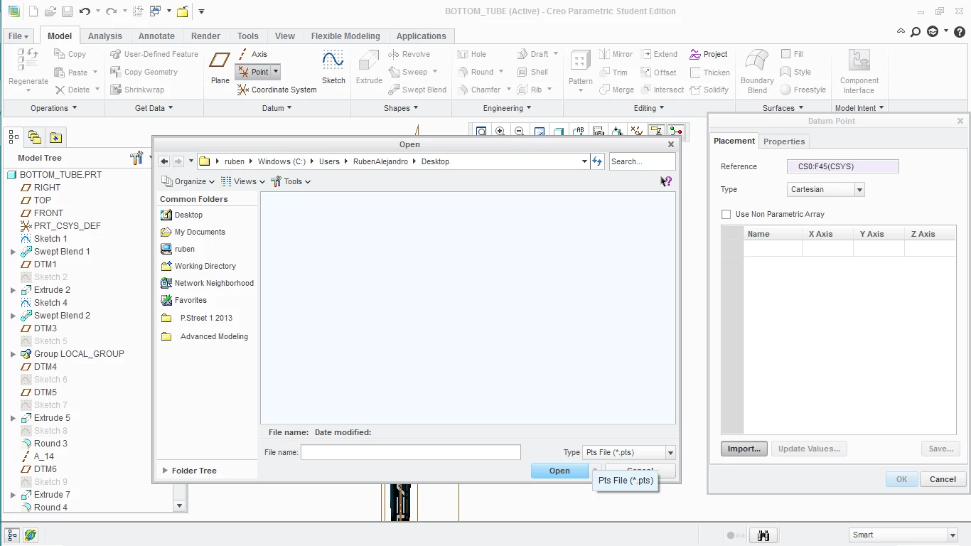

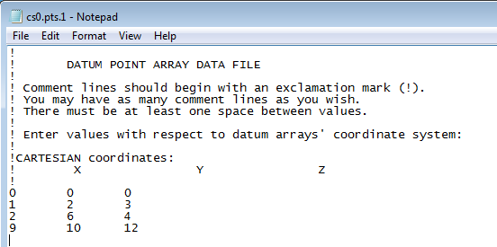

I measure the points of a real curve, and I put it in an Excel file. Now, there are several points and I do not want to put it in the table one by one. I know that I can import tables, but I don't know how to make a .pts file that allows me in other ways, copy and paste the points, to import them to Creo.

Even easier: Instead of creating a separate file, choose "Update Values". An editor pops up and you can copy and paste your Excel values here:
Don't worry about aligning the columns; as long as there is whitespace (spaces or tabs) between the values, Creo can handle it.
