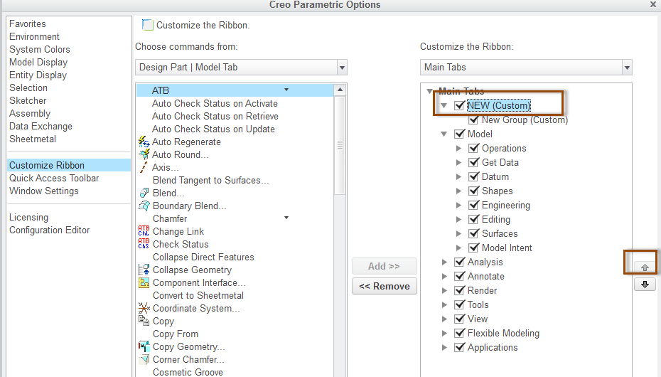

I have created a tab for my model and drawing and I want Creo 2.0 to open up with this tab pre-selected not like the layouts tab in the drawings.
Best answer by Mahesh_Sharma
AJ,
First tab in UI will be default active tab. Move up the custom tab when customizing the ribbon.
6 replies
Mahesh_Sharma
22-Sapphire I
October 10, 2014
AJ,
asmith-31-VisitorAuthor
October 15, 2014
I already have the new tab I created as the first one on the list, but for instance when I open a drawing the layout tab is always the tab that is activated when any drawing is opened. Now I want to make the new tab I created to be the initial tab that is activated when I open a drawing, model, or assembly. How do I go about doing this?
Mahesh_Sharma
22-Sapphire I
October 15, 2014
You need to add that tab in all modes seperately i.e. Part, assembly and drawing
