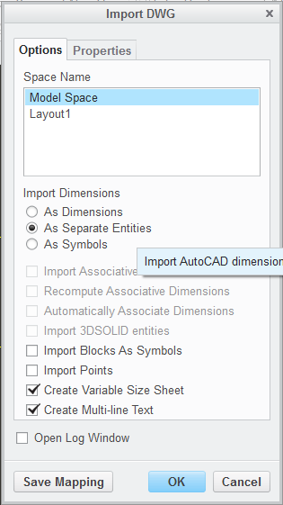

After the scale you can export to DWG and import again using the option "Import Dimensions As Separate Entities"
Do the inverse scale now that the dimensions are not associative.
That should do it.

Oh very cool! I have never used that option. Thank you!
