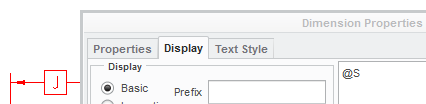

For @s its only taking whatever mention in name it wont allow spaces.
I need to mention DIM C so I am mention Name as C & in description I am writing DIM @S
It results DIM BASIC C not BASIC DIM C.

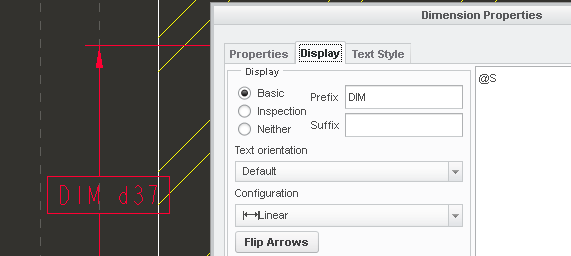

If you add "dim" to the prefix box, it puts it inside the basic box.
OR
use the coding mentioned by Chris

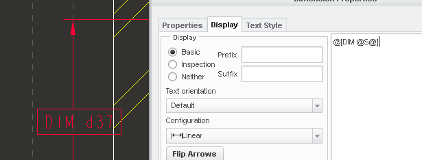

@[DIM @S@]
to get the desired result without using the basic toggle

Thanks Stephen;
Helps me a lot
