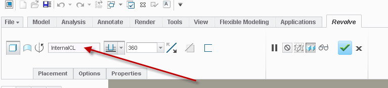

I'm using Creo 2.0 and trying to revolve a mirrored sketch using a centerline that is outside the sketch as the center of revolution (specifically, an axis datum I made by intersecting two planes). However, when inside the sketch, I used the "centerline" sketch tool in order to provide a line with which to mirror the sketch about. Because the sketch contains a centerline, the revolve feature automatically thinks that I want to use this internal sketch centerline to revolve the sketch about, but this is not allowed to happen because "All entities must be on the same side of the revolving axis." Thus, the section is deemed incomplete, and I cannot complete the sketch.
How do I tell Creo I want to use an external centerline, not the one I used in the sketch, as the axis of revolution?

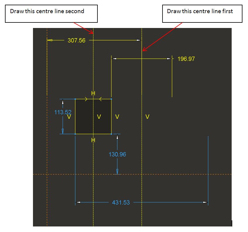

I always thought the feature was revolved around the first centreline you draw?
Patriot_1776
January 6, 2017
In the Olde Days, this was true, and it was a PITA.  Years ago they added the ability to pick any centerline, or use an external one.

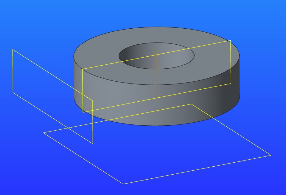

Based on your question, you made a sketch with a centerline in it.
You have an axis in your model.
You are making a revolve feature using the sketch (external to the feature) and you want to use the datum axis you created as the revolve centerline.

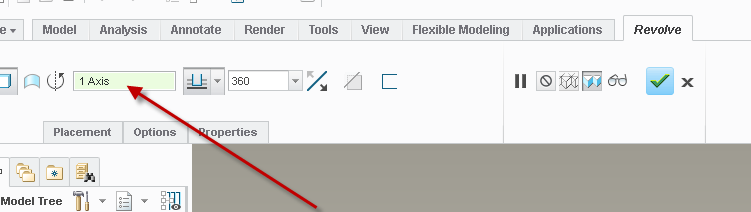

Create the revolve as you have been, when you have the sketch pre-selected or you select it in the feature, it assumes you want to use the centerline in the sketch (as you have discovered). Simple solution is to select the axis selection box (which by default says internal axis) and then select the axis you created. It will let you choose any axis to replace the internal centerline.

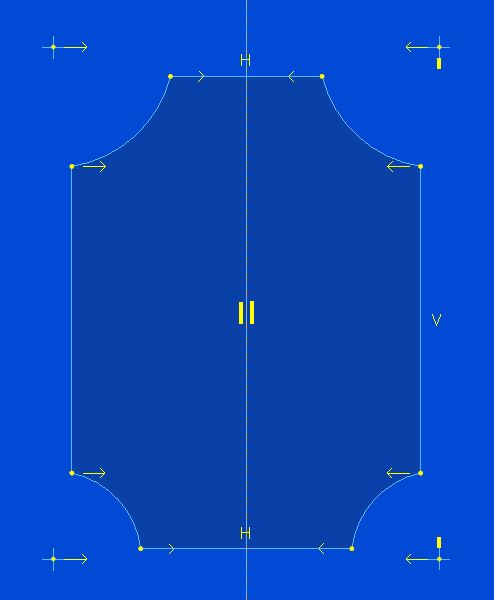

If I've been able to recreate his problem, in Creo 2 M120 at least, the problem is Creo won't allow you to select the sketch if it has a geometry or construction centerline defined in the sketch. Creo also doesn't allow it to be pre-selected in my case. The sketch as I understood it is different than what you have shown, he used the centerline in the sketch to mirror geometry about it so he has a sketch with geometry symmetric about the internal centerline which causes the problem. This is what I understood to be the issue:
Sketch internal centerline removed to create revolve:
Centerline re-added to revolve and geometry re-mirrored:

This works for me:
Gives me this:
Is that what you need?
