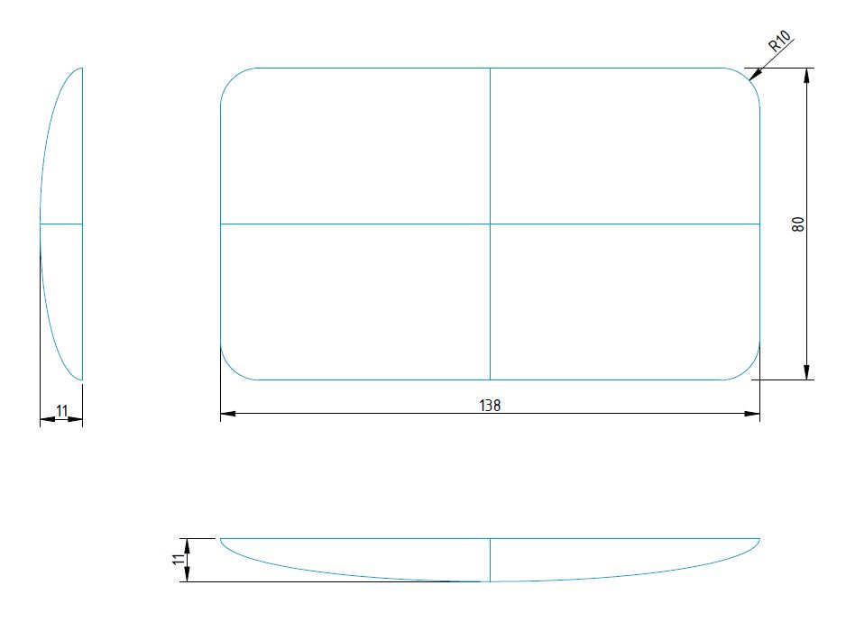

Can anybody pls help, i need to model a part as per the attached image.

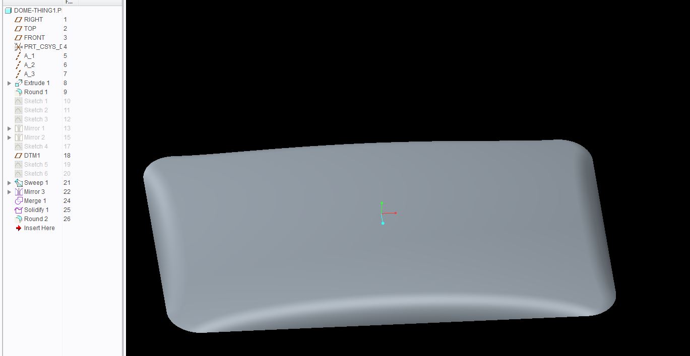

StephenW
July 14, 2015
The way I have done is to build 1/4 of it using curves, then use those curves to create a surface. Once you have 1/4 surface, you can mirror the surface to get 1/2 then mirror again to get the  whole. Then merge the surfaces. Once merged, you can solidify or add thickness as needed.

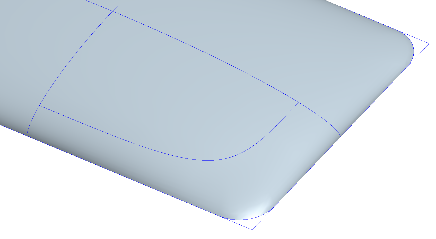

Here's one approach:
2X conic sketches
rectangle boundary blend trimmed back
4 sided boundary around perimeter

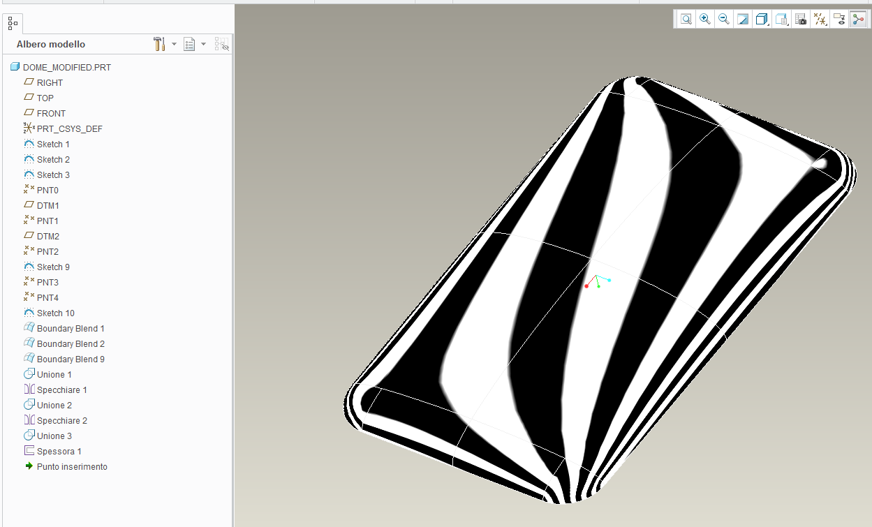

July 15, 2015
Hi Steven,
i've taken your file, reduced number of sketches, added normal and tangency costraints to boundary blends and substituted style feature (requires license) with a simple boundary blend.
Take a look if you're interested. Creo 3.0 file attached.
July 15, 2015
Probably not blended as nice, but since there is nothing defining that in the original post. IT'S PERFECT!

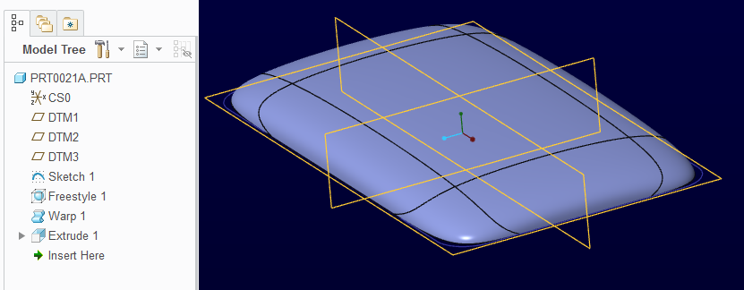

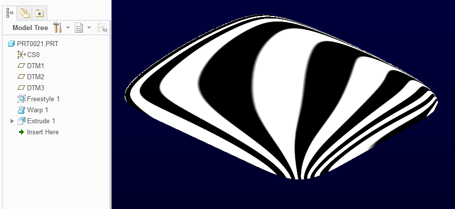

July 17, 2015
From a purely stylized perspective, I like the attached version.  Just difficult to control specific dimensions.
Creo 3.0 commercial version attached.
prt0021a is closely scaled to the original.  If I was better at manipulating the primitive, it would be darn close.
Patriot_1776
July 17, 2015
Smooooooth!    Nice work!
