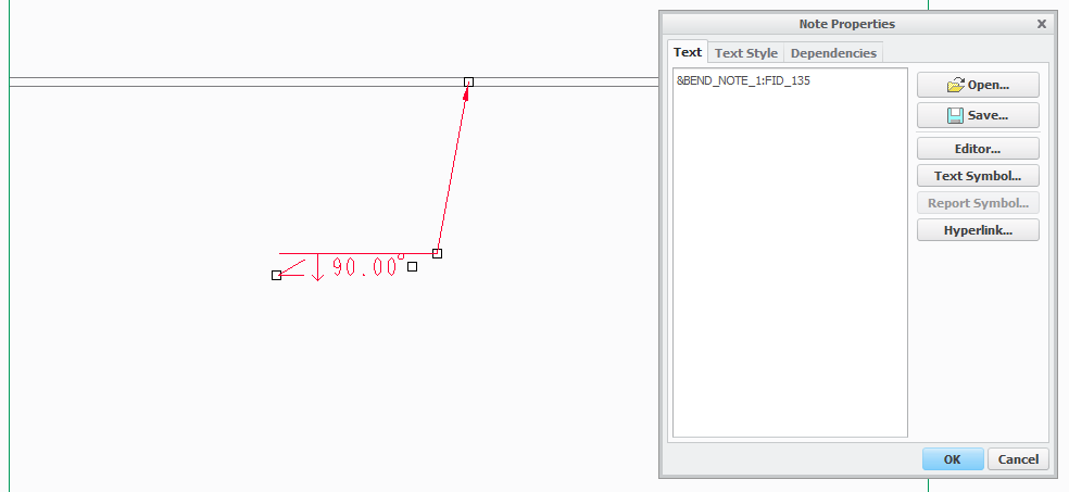

Hello, Is it possible to move the atachment point of  bend note in sheetmetal drawing? I can move the text but need to move the attachment point also (to move along bend axis).
I have long part and need to show the view as broken, but I cannot bacause the attachment point of the note is in the middle of the bend axis, therefore if I want to show the bend note i need to show also the center of the view else the note points outside the view.
(in creo 3)

Best answer by JLG
Find out what the bend note contains:
Create a new note with this same content (in picture, "&BEND_NOTE_1:FID_135").  Erase the original note.

Hi, You can right click on the attachment line and select change reference. The only problem is that you lose the link between this note and the model as the warning message you'll get says. I think this is the only way to do what you want.
JLG2-ExplorerAnswer

Ok, this seems to be better solution...
