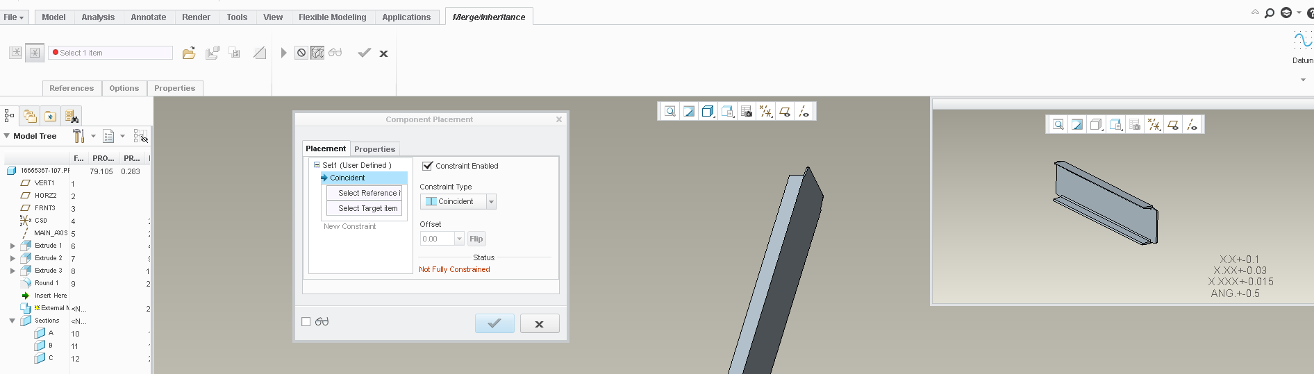

Have you considered using merge/inheritance to bring the data in to your part file? It brings a part file in to another part file and you use the same component placement dialog as assembly mode.
Model tab - get data drop down arrow - merge/inheritance.

This would mean that we would change our methodology somewhat but it would do exactly what we are looking to do.
Sometimes you can use tools for quite a while and not realize there are options above which you use.  That would certainly be the case here.  I believe I've always just defaulted everything that I merge/inheritance.

Another option is to create a CS in your part at an angle and align your import to it.  Once imported you'd tweak the angel to get the planes parallel.
