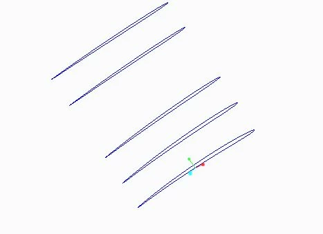

I have aerofoil on a plane which is as shown in fig.3 of attachments they are lying on the different parallel planes. but I want to have them like how they are shown in images 1 and 2. In images 1 and 2, the aerofoils are projected onto right circular cylinders fashion. I have attached the igs file of various splines.
Best answer by BHOoi
This looks straight forward. Create the cylindrical surface and then project those curves to it.

Use the Project feature to project a sketch onto a cylindrical surface or quilt.
Also look at the Wrap feature in case this is more appropriate.
February 28, 2018
Thank you, I should use a wrap instead of project command as it gives the exact shape and size. How to blend after wrapping all the curves
February 28, 2018
I do have some luck with boundary blend but a sweep-blend feature may also work for you.
February 28, 2018
Thank You, it helped me to solve my problem to some extent. How to blend those curves to make them into a solid model
