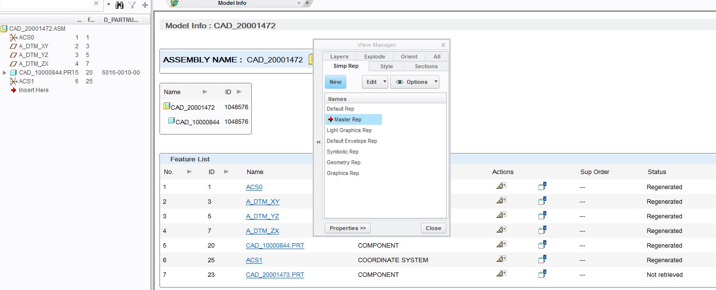

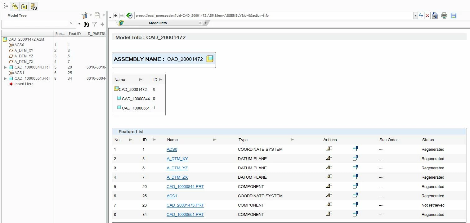

When I dig a little deeper and use Model Info for the assembly, I get this interesting screen shot attached to this question.
So how could I get rid of this not-listed-component?

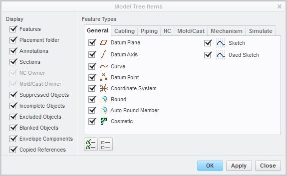

You say the mystery component is not in your Model Tree...are you sure? Have you checked the Tree Filter settings to make sure that Suppressed objects are displayed?

I tried this in the first place, but all options are checked (even in "cabling", "piping", etc.).

mystery component is not retrieved (see Status column), check Master Representation.

even in Master Rep the problem remains:

1.]
Click Properties to see detailed information concerning Master Rep.
2.]
Firstly open mystery component and then the assembly. What happens ?
3.]
Open Case at PTC Support. They can investigate your data and repair them.
