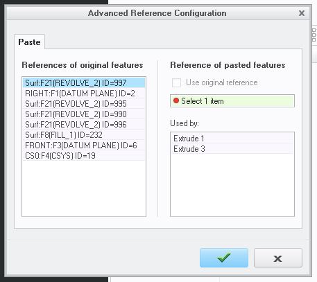

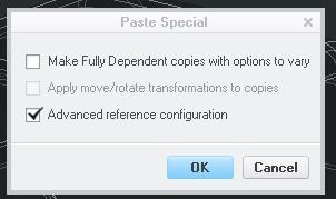

I'm a bit confused as to what you are trying to do.  Are you trying to copy a Creo feature (extrude, revolve, etc.) from model A to model B or are you trying to copy geometric entities (surfaces or curves themselves) from model A to model B?
They are quite different things and require very different approaches.
Since you mentioned copy & paste and that doesn't work on geometric entities, I'm going to assume that you mean features.  The best way to do this is to use paste special > advanced reference configuration. It's a very powerful tool. I also find it easier if I have both models open in separate windows on separate monitors.
Go to your source part and use control to select all the features you want to copy in the model tree.
No go to your target model and select paste special from the flyout menu under "paste".
In the pop up dialog, select Advanced reference configuration and nothing else.
In the next dialog choose a scale factor, if desired and select OK.
Then the Advanced Reference Configuration dialog comes up showing every reference used to create the features in the source part and allowing you to pick new references in the target part.
Here's where having 2 monitors helps. Creo also highlights the references in the source part to help you pick the correct new ones in the target.
Once you've got all the new references chosen, assuming the geometry will work in the target part, you'll get an exact duplicate of the features in the target part and it'll appear in the model tree exactly as it did in the source.
I use this technique nearly daily and find it really speeds my work.

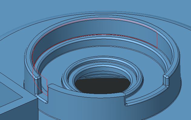

I am dealing with an assembly with several components. I am trying to copy designated geometry features (surfaces, splines etc.) to another model (a blank model) so that these features can be saved separately with no dependency on the original assembly.
I can copy and past geometric feature (not Creo design feature like extrusion) within the same assembly file. I can also copy and past in the same component and the copied feature will synchronize in the assembly as well. The problem is that I cannot find the location of the copied feature in the assembly. As you can see in the figure, the colored surface is a duplicated face in the assembly but it does not show in the model tree.@Doug Scharfer
I have tried your way to copy & past, but I could not repeat your work in a blank model. The reason might be that when you create a new model, this model is in  a new session so that it can not find the copied content in the clipboard.
April 5, 2016
The method I posted is for copying features, not geometry entities.  Within the assy, if you are highlighting surfaces and selecting copy then paste you are creating assy surfaces, not part surfaces.  By default in Creo, I believe that assy level features might be hidden in the model tree.  Check the model tree filter settings under the hammer & screwdriver button in the model tree.
