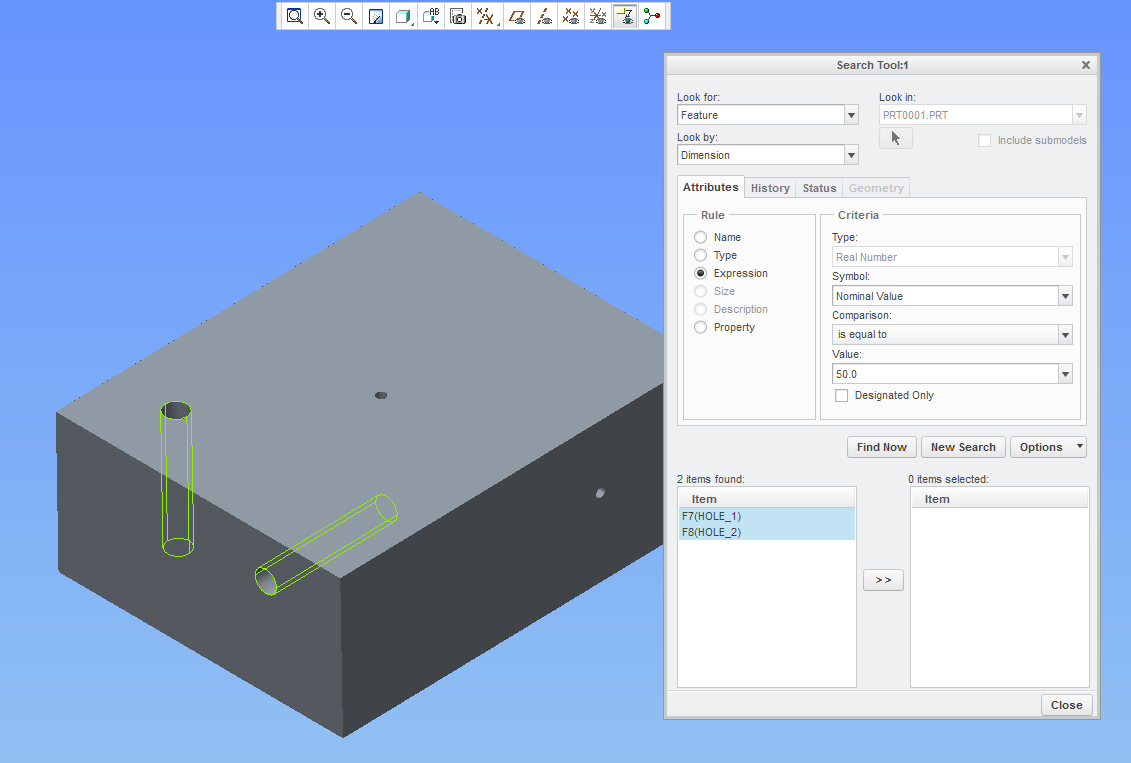

Hi Dhinesh,
best way to filter thru assembly is search tool.
To find your holes based on dimension you must set it something like this:
You can save your query as a layer so you can pick those holes again if needed quick.

But while searching patterned holes; It shows only the first hole
I am using WF5
I am not sure about CREO Features
August 29, 2011
Yea, i`ve been trying to build a query but can`t make it show all holes in pattern only the first one.
Problem seems to be that other pattern holes "borrow" dimensions from first one so in search by dimension only first hole shows up.
