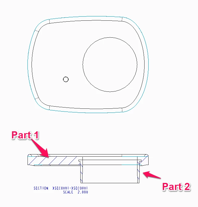

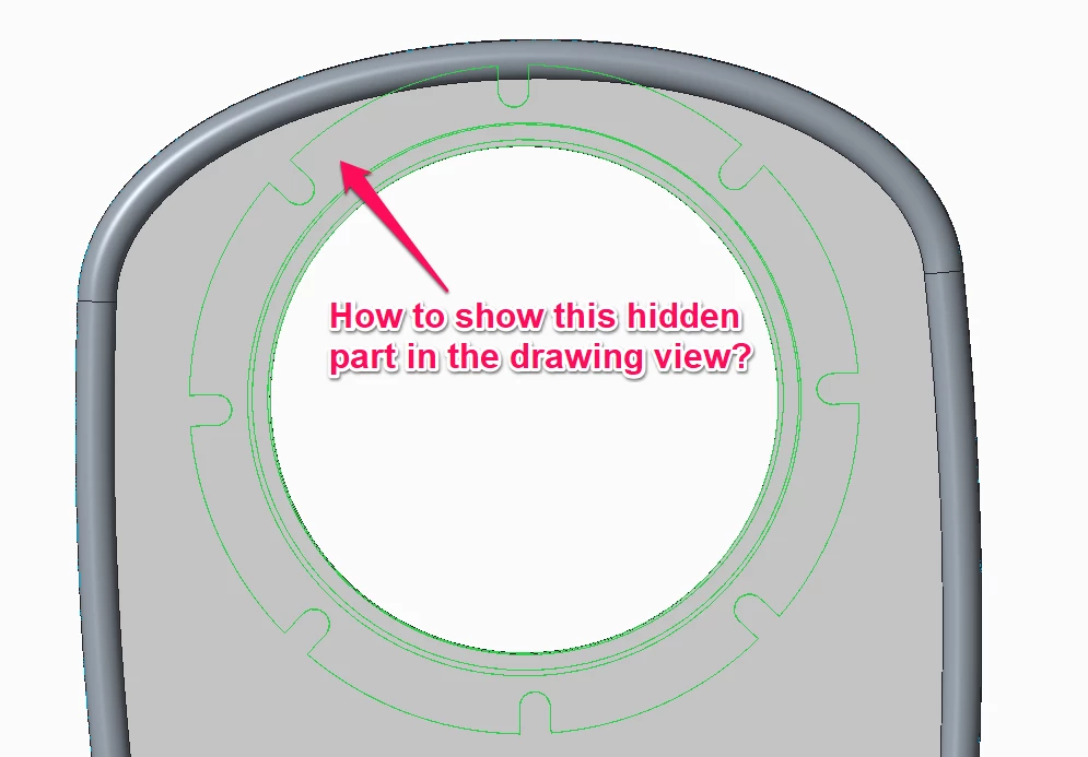

Can anyone tell me how to show a hidden part in the drawing?
This might be a centreline or different representation.
The most important part is - I don't want to use Display Style - Hidden.
Thank you

You could add a second model with the two parts assembled and reference that. Just set your drawing model back to the main model before you exit.

Change the view to show hidden lines.
Select the view, rmb properties, view display, display style set to Hidden
