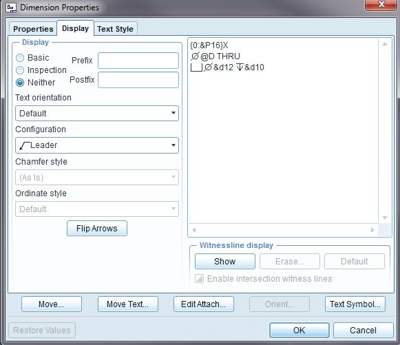

How to show the free hole & counter bore note in drawing as per ASME with fully parametric
Best answer by Kevin
Show one of the dimensions for the hole. You next need to determine the parameter names for the dimensions you want to combine into a single note. You may want to show the dimensions on the drawing and use Switch Dimensions which will show the parameter names. This can also be done in the part model. If your holes are part of a pattern your note will have the following form:
Kevin1-VisitorAnswer
May 3, 2011
