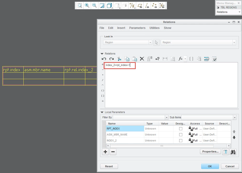

Best answer by Domen_130833
You can`t do it directly with rpt.index.
What you can do is create new parameter in repeat region (rpt > rel... > User Defined > write something like: index_2).
Then go to Repeat region Relations and write: index_2=rpt_index+1.
7 replies
July 27, 2016

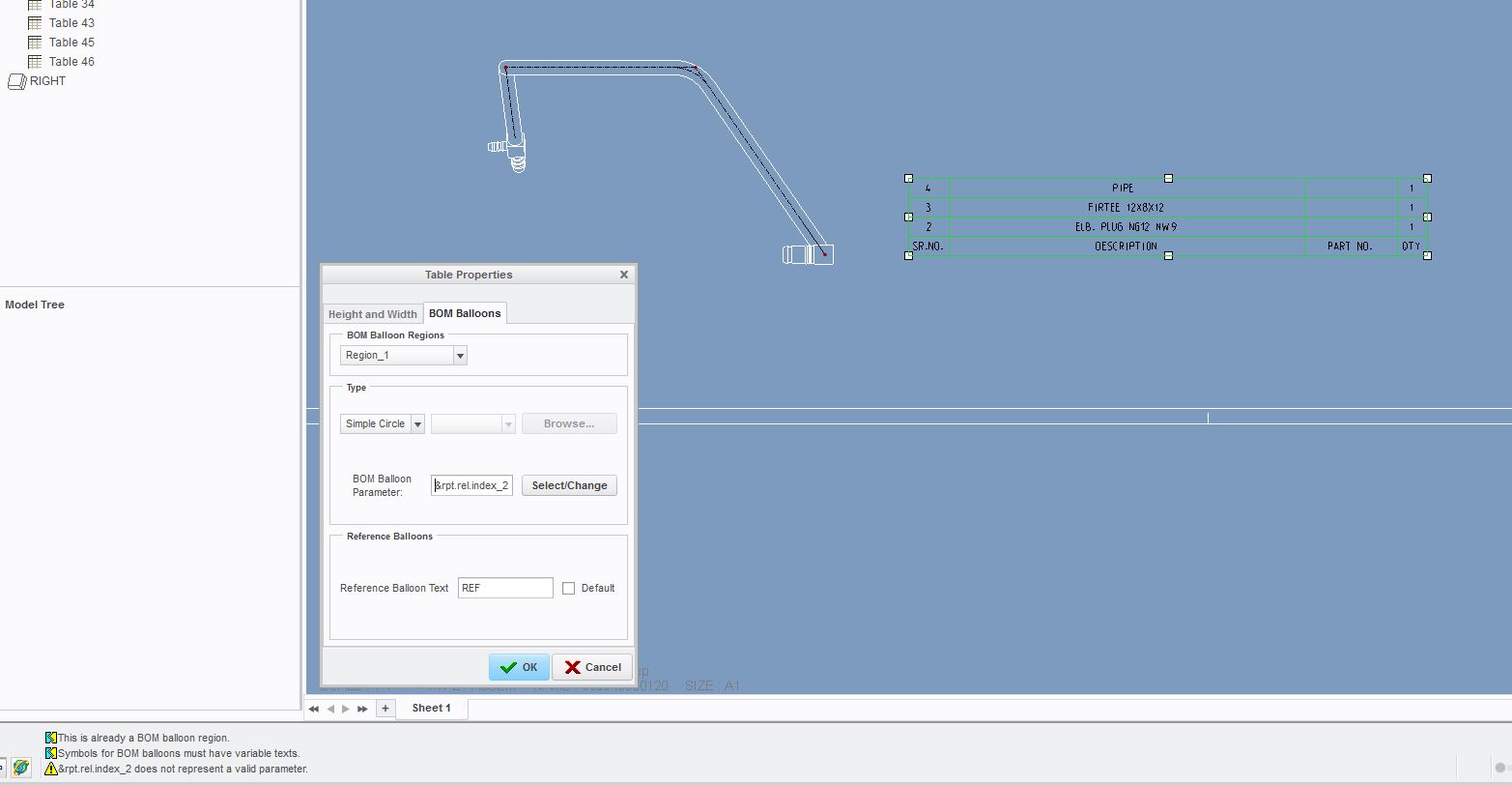

Hi..
yes, it is working for repeat region table but it creates issue in BOM balloon.
I am trying to create BOM balloon for &rpt.rel.index_2 as shown in below snap but it is not taking.
now my half problem is resolved in repeat region table and half is remaining for BOM balloons.
so please can you suggest.

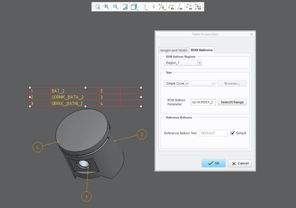

July 27, 2016
Lose the ampersand (&) in the BOM Balloon Parameter.
See the attachment picture.
