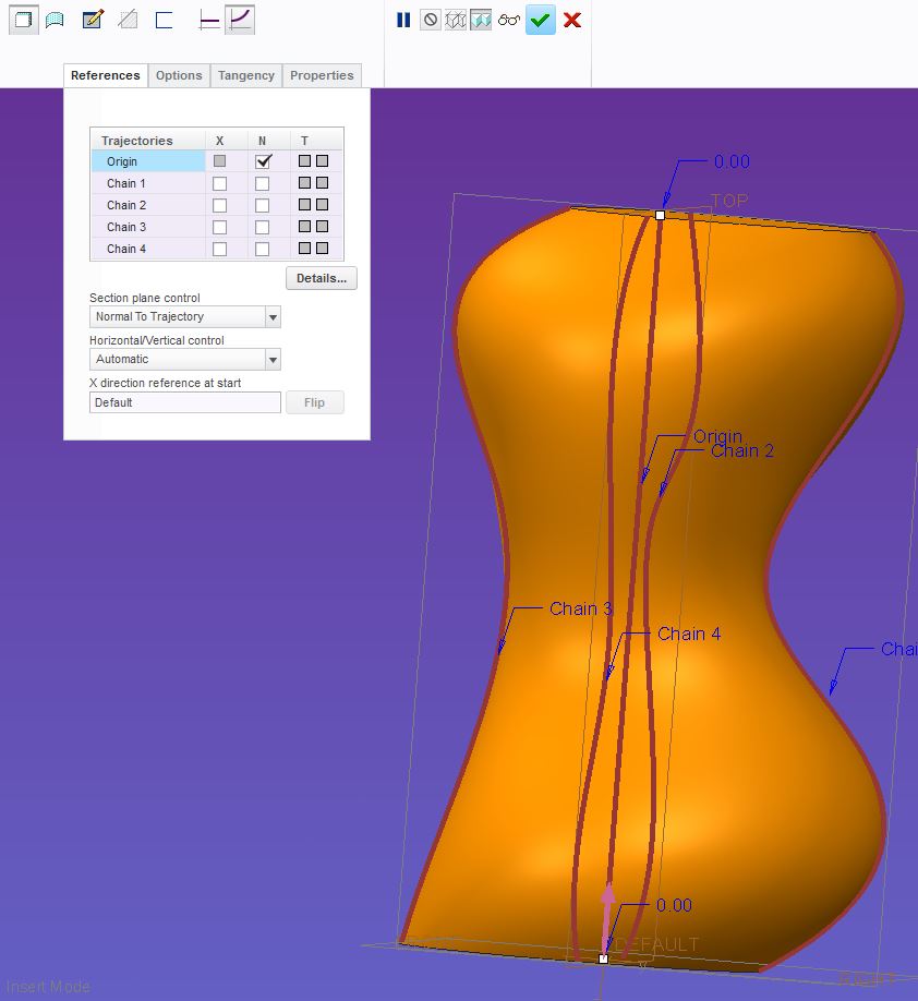

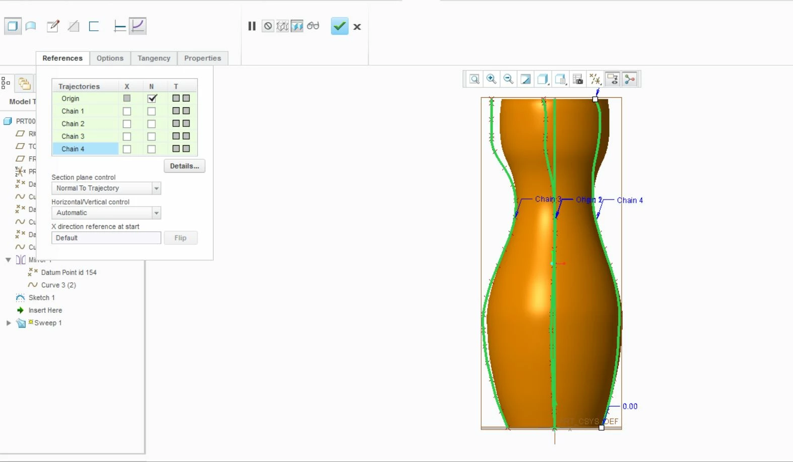

Hi guys,
I want to create a bottle with 4 curves that using offset coordinate system to make points. When I finished from creating 4 curves and 1 straight line at the center, I used the sweep tool, but the model is not working through the points that I created. Anyone have a suggested ideas of what I could try?
I have attached the part file of the problem.
Thank you,
Best answer by Patriot_1776

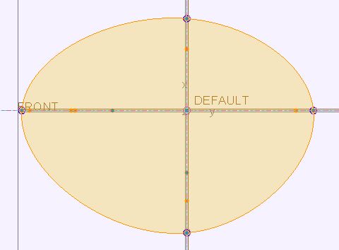

First, the element in your section must be ABLE to stretch and contract as pulled by the curves, in other words, an arc may not work, you may need to use a conic or ellipse.  Second, you must be careful to pick the "reference point" reference for your trajectories.  Third, and most important, in the sweep tool, you must make sure you do NOT have the "constant section" option on.
Patriot_1776
October 13, 2016
October 13, 2016
section defined in your sweep feature is a circle. Creo cannot warp circle to "something else" to follow your curves. You have to modify sweep section as mentioned.

How are you constraining your sketch curve.  It must be constrained to the end of all curves and the they must all end on the sketching plane.
