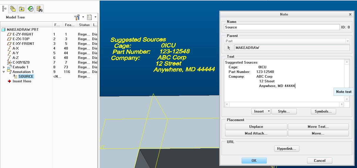

I want to be able to use tabs in the annotation notes and have them stay.  Currently when I use tabs it will work so long as I don't complete the note process.  As soon as I complete the note process the program removes the tab justification from my note.  The intended result would have given me a left justification for identifier text and tabbed justification for explaination text.  Using spaces will not line up the text as lettering have specific horizontal sizing per each letter.

Could not get the tab or any other code I know to "tab".
It did take straight spaces, but formatting becomes a pain...
as you can see, the text in the editor is offset but in the model it is inline.

There are no tab stops, so there is nothing for the tab to tab to. It's possible in some text functions to use different fonts by segmenting the text and changing the font size of the segments to control text placement. For example, add a space in a different font size to change the gap between words.

They also exist in other editors that can be used to edit notes, but there is no model configuration for tab stops.
