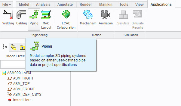

hur aktiverar man pipe funktionen i Creo?
Best answer by AmitDeshpande
Hi Reza,
You need to be in an assembly in order to access the Piping functionality, via Applications > Piping.
Amit

How to Enable pipe in the Creo 2
how to activate the pipe function in Creo ?
18-Opal
July 29, 2016
Hi Reza,
Amit
rtaleb1-VisitorAuthor
July 31, 2016
thanks it works .
you can not use the pipe under prt ?
18-Opal
August 1, 2016
That is correct, you cannot access the Piping functionality from part mode only assembly mode.
