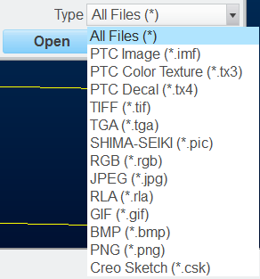

I think it is not possible. Following file types are allowed.
