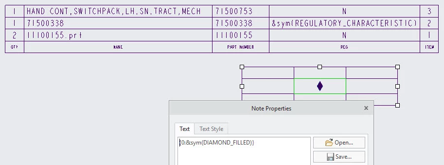

I realize this is an old post, but I feel that I am close to a solution, that just wont work...
I have added this in the Repeat Region --> Relation
REG = ASM_MBR_REGULATORY
IF asm_mbr_regulatory != "N"
REG = "&sym(REGULATORY_CHARACTERISTIC)"
ELSE
REG = "N"
ENDIF
ENDIF
The results I get is the name of the text field populated in the table, however, I don't get a visual of the symbol.
If I create a standalone table I can get the symbol to show easily...

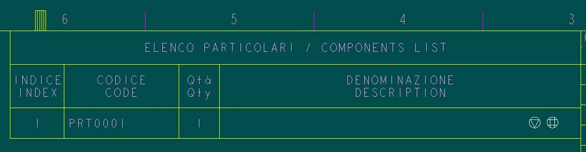

cspinelli14-AlexandriteAuthor
August 20, 2019
thanks for the answer, in fact i have already solved the problem in another way because it seems that no symbol could enter in a repeat region. so i use a customized set of font in which i have replaced font % and $ with our needs. then i have added only a parameter named SECURITY that alternatively is % or $ and the result is the one in the image below
