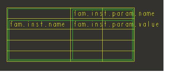

have you used a two-d region and use fam. as report symbol?

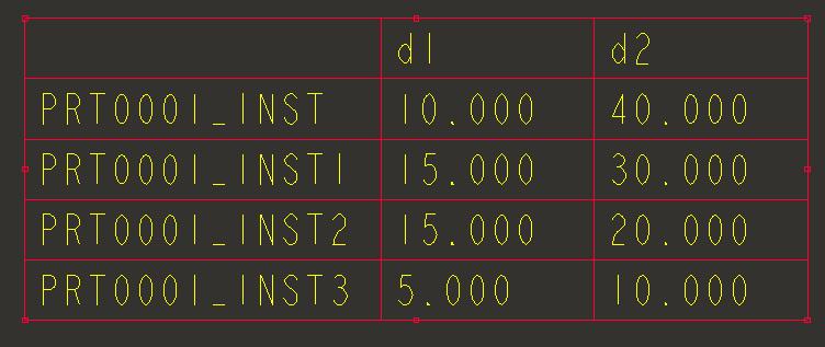

the followings are the tables for your reference. hope they will help you someway.

I have attached a .tbl file for a repeat region table based on a part with a family table. Try creating a table from file using this file to see if this is what you are looking for. The formatting and such may not be as desired as it is pretty generic, but perhaps it will help you see how to set it up.
Also as a side note make sure that when you create the table that the generic is the model being used for the table creation. Sometimes when creating a drawing we will show a view of and instance, and then the table will reflect the family table from the generic but the we have to be sure to direct the table to use the generic model as the model for the table or else the repeat region gets lost.
Hope this helps!
-Greg

Yes, this is what I needed. I see now the definition of repeat-regions and it makes sense. The same definision was in Linda's example but I didn't realised.
My problem was that I was trying to do the entire table with only one repeat region 😉
