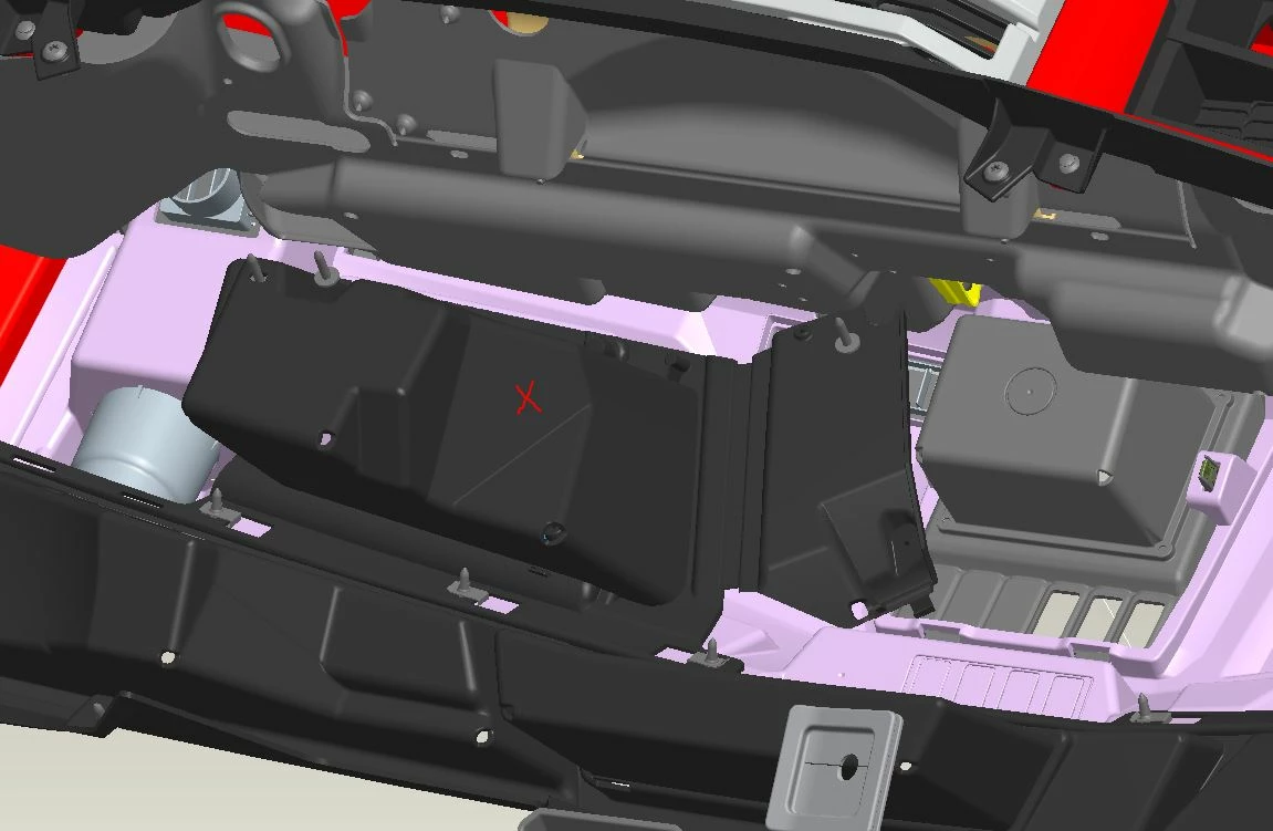

Facing some constrains with interference anlysis in Pro-E. We are basically into Vehicle designers in large assemblies. Our team will be working on different parts and assemblies to get it done. But the final interference analysis is taking a hell of time of our time utilisation.
Problem: To check the interference analysis with a single part (current working part) and the adjascet parts (not all major sub-assemblies)
We cant make master rep by selecting/finding out the parts which are surrounded by the current working part.
Solution: Looking for a tool/Macro to analys this issue in very simple way to get it done...!!!
Any advanced interference check tool within Pro-E 4.0..?
Any window selection method to make a represenation of the surrounded parts...?
Attachment: In the attached picture, suppose the cross marked parts refers the current working part. How can i check the interference with other parts (this is a big assembly, here this might be very easy).
