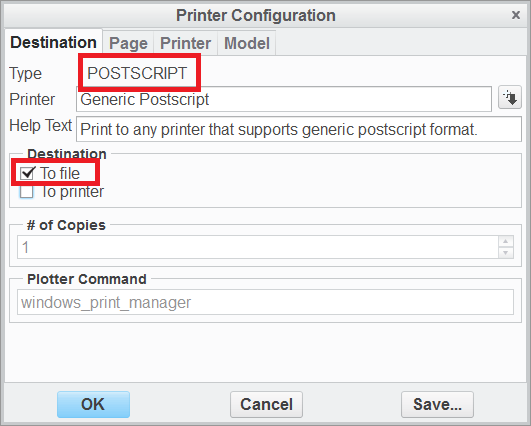

Heiko,
when you print from Creo, do you use MS Printer Manager Creo printer -OR- Postscript Creo printer ?
May be you can create group of Postscript files representing sheets of your drawing and send them to the print from Command prompt window using copy command to test nesting functionality of the printer.
Martin Hanak

September 4, 2015
Heiko,
do you use this printer from Creo 2.0 ?
This way you will get Postscript files with .ps or .plt extension. try to send them to your printer.
Martin Hanak

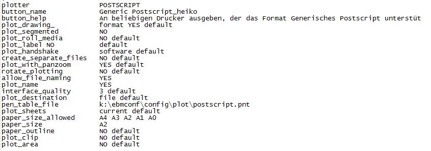

hhagedorn10-MarbleAuthor
September 7, 2015
Martin,
thank you again and again for your patience and your support!
I would like to comment your last posting.
No, the drawing what we have as a test file includes no picture on it.
Yes, it is a Windows Printer who knows the language "postscript".
And yes it seems to me that this depends on a Windows Print Manager.
When you talk from the Windows printer settings dialog box, do you mean the dialog box who pops up when you print in Creo??
The settings of this box is, are stored in the *.pcf file.
Can you help me what has to be set about in these settings?
At the moment for the expression test, I've just used a PCF File snapped to test it, the current settings are:
Heiko
P.S. Sorry if I might ask some things behind a little odd or I am on the wrong track, but printing is not my area of expertise.
September 7, 2015
Latest Update!!!
After I have made the following settings: rotate_plotting yes, the plotter interleaved also the printjob of Creo!!!!!!!!
Now it comes the finely tuining!
Thanks for all!
