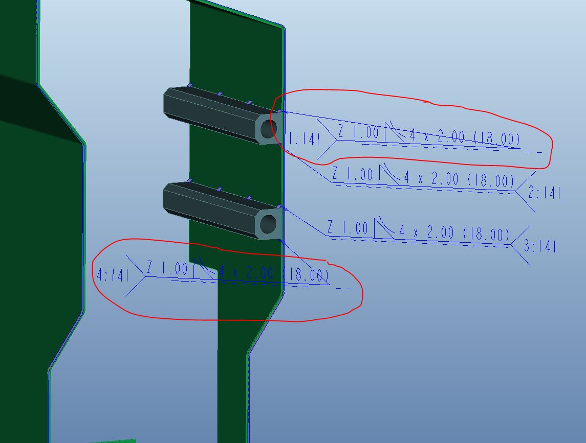

My problem is only in the visualization of the 3D notes within the weld environment.
I've setted the view plane and the orientation of te text in the
View -> Annotation orientation
When I make a weld, sometime the foot of the arrow is on the right side, sometime not; and then I'm not able to invert the side of the text.
How can I do?

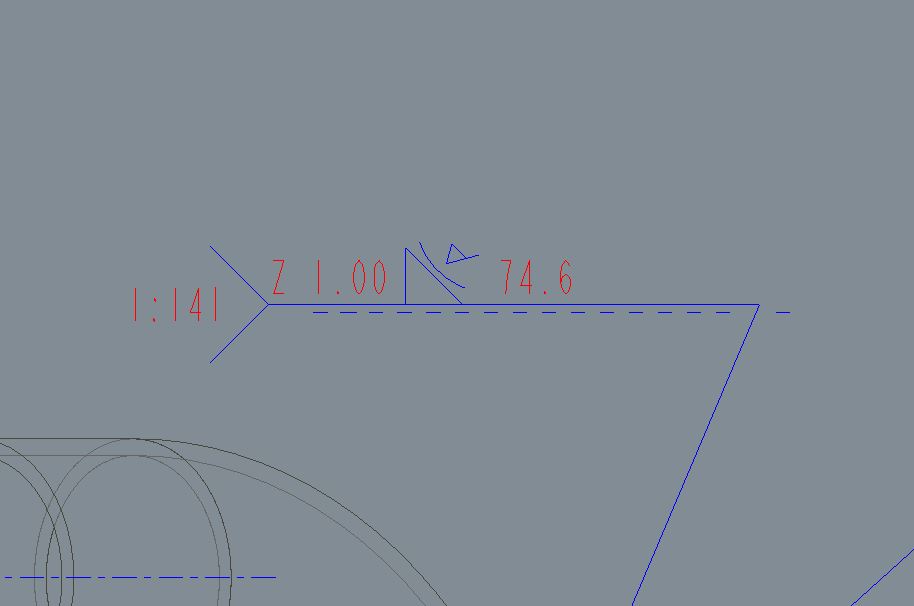

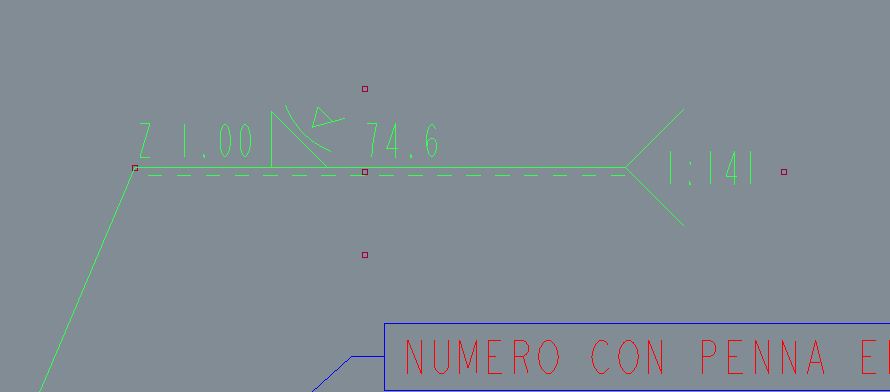

I've found a way but you have to go into the drawing environment.
Here you can move the text from left to right of the foot of the arrow. Once done it, you have the text inverted also in the 3D.
