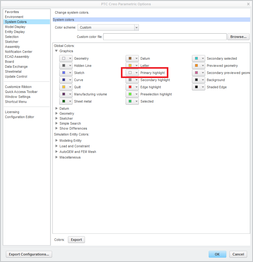

In draw mode, I like to work with a black background and the crosshairs are currently red. Where or how do I change the color to white?

Bill,
in Drawing mode when you sketch 2D geometry, you can see a crosshair. Its color is driven by Primary highlight system color. You can change it from dark red to white (as shown on the picture). Unfortunatelly this change affects other Creo "areas".
Martin Hanak

Bill,
Martin Hanak

Martin, that's exactly what I wanted. Thanks so much!
