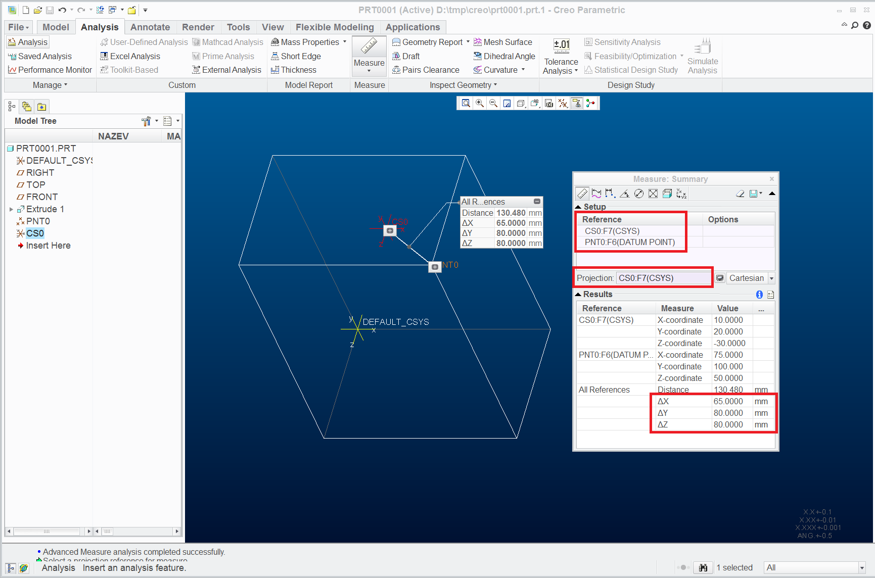

Is it possible to find the x, y and z of a point relative to coordinate of file?

April 9, 2016
Murilo Silva
Go to the ANALYSIS tab
Use the Measure Types drop down tool
Use the Summary tool
Pick the point you want to measure
The popup window will display the delta X,Y,Z values to the prime Coordinate system.
Leif
