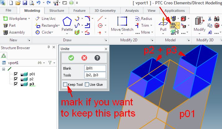

Best answer by FriedhelmK
Hello Doug,
this is for PTC Creo Elements Direct Modeling or Express 6
There are some rules.
Read the help on the topic if you have problems.
Click the black question mark
Enjoy it

Hello Doug,
Enjoy it
dbarton-21-VisitorAuthor
November 22, 2015
Hi, thanks. It is the unite command that does what I want.
