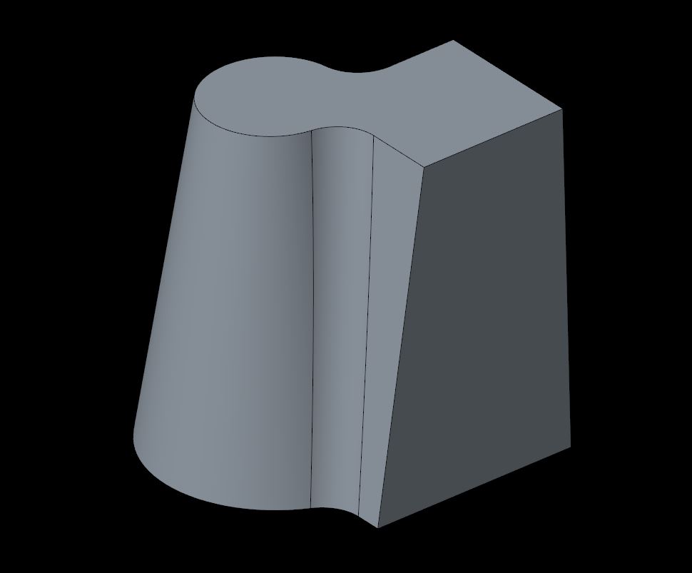

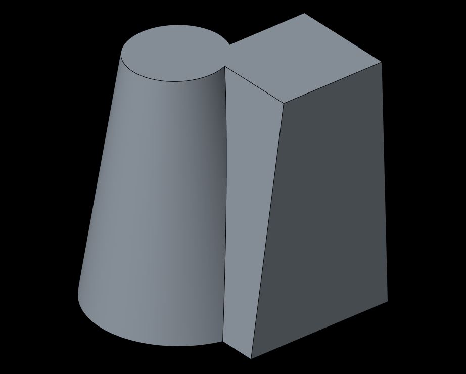

We come across this issue every once in awhile in our Wire EDM Department. The wire needs a straight line radius because the wire should not bend.
Is there a round feature that will give us a point to point constant round between these two primitives.
A cone being intersected by a tapered cube.
When we add a constant round the resulting (long) edges of the round become bent.

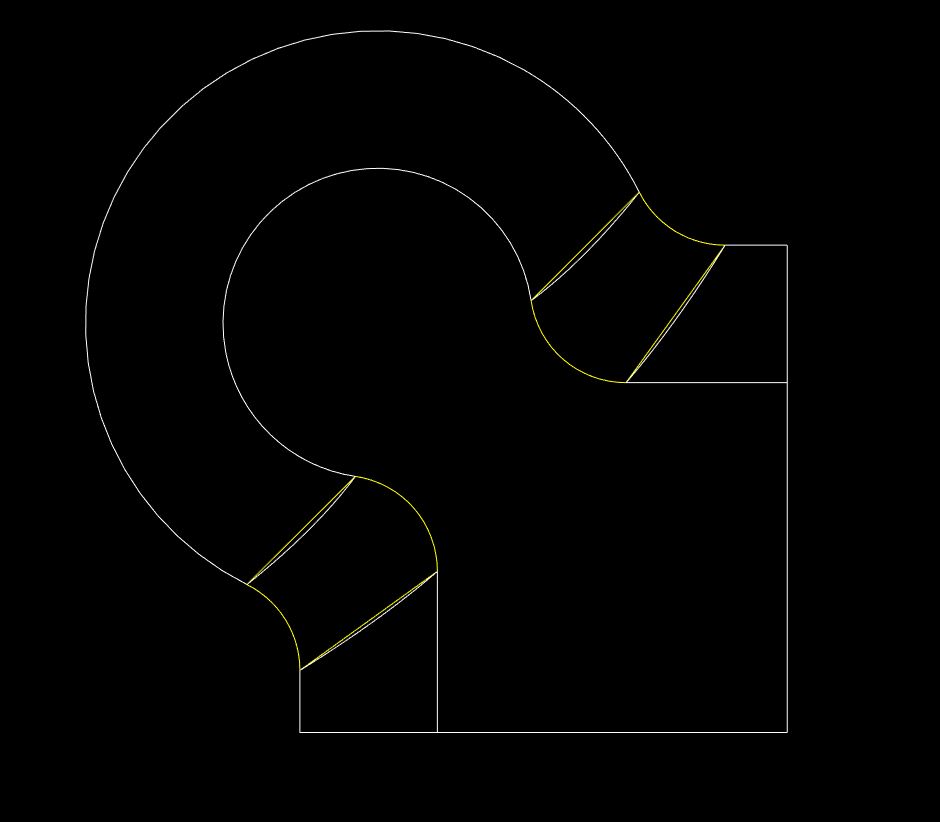

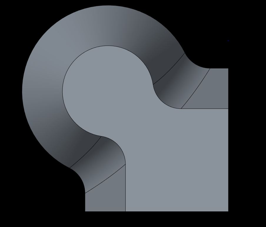

When looking from the top they look like this.
Here I created a boundary blend (yellow edges) between the upper cure and the lower cure (short edges of the round) to shot what result we are looking for. You can clearly see the bend in the long edges.
Is there a round feature that will give me the straight long edges of the round. Or, is this just impossible.

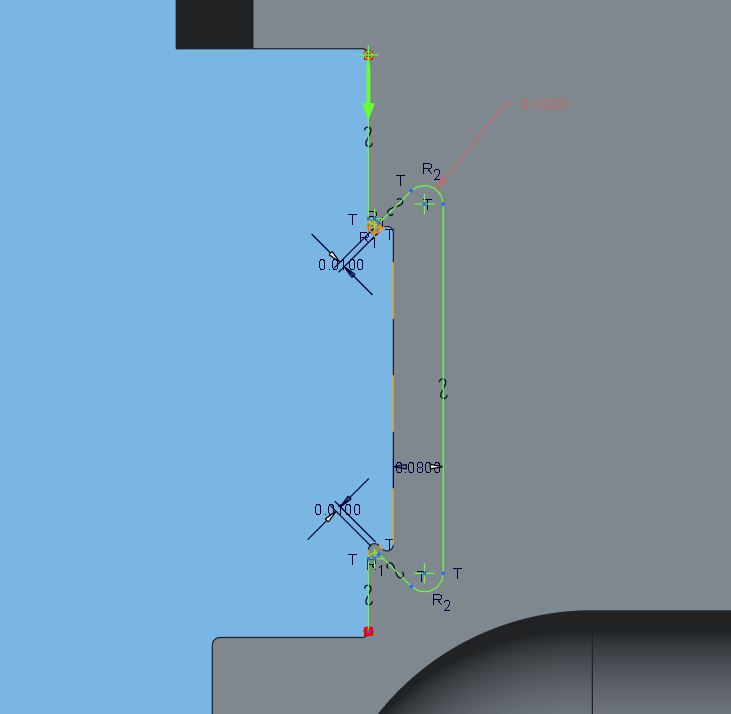

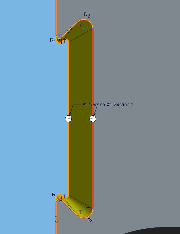

Yes the feature you are looking for is a blend.  We do this every day with our Agie wires. Your can create same size radii for the top and bottom profiles or you can have different sizes and it will still create conical or wire friendly geometry.
dplachinski12-AmethystAuthorAnswer
February 11, 2016
Thanks Nick,
I think this may be the way to go. I have mocked up a few different versions of a stripper block and core insert for our wire department to look at for programming. If all goes well with the "bled" approach we will have a solution and maybe a new process to create wired inserts.
Dan
February 25, 2016
This method was preferred by our wire department. There is one drawback, but it doesn't seem to affect the Wire EDM programming. The drawback is, the created radius is not a true diametric shape ( you can not put an axis through it).
