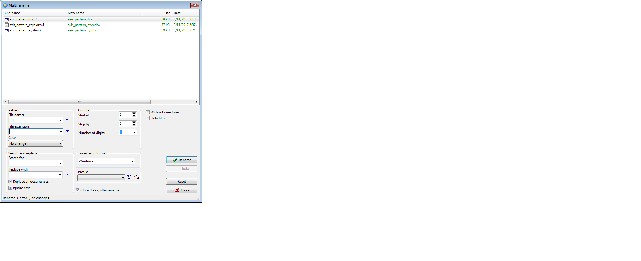

We have over 40,000 files and would like to convert from versioned to non versione.  Is there a utility out there that will do this?

    Well, I know that a file manager called FreeCommander can be used to do this:
    It's freeware, you can download it at http://freecommander.com/en/downloads/‌

    Hello Greg Kling
    what about show/hide file extensions:
    How to Show File Extensions in Windows 7 - YouTube
    Clear all versions with:
    Spekan Purge 3.3
    Regards
    Milan Bonka

    Thanks all. In a nutshell, the reason is because we have gone from a PLM setup to stand alone.  Our system is very slow so we would like to work locally and then move the local files to our server where the 40K plus files are stored.  The only way we see to do this is to have the master files be not version controlled so when we drag and drop our day or weeks worth of work, that it will simply overwrite the non-creo versioned files.
